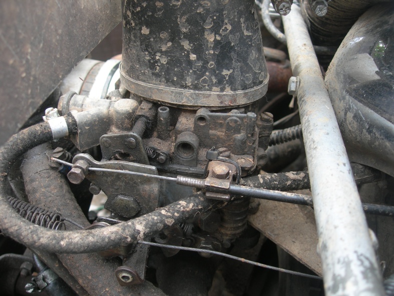

Can anyone identify the carburetter fitted to my M28 602 cc engine. I have no idea of the history, so the carbureter may not be original. It's a twin choke solex and has the numbers '27 B019 01' stampled on the float bowl. There are also two casting marks '24' and, I think '21' either side of the 'SOLEX' marking. Could the carb be a 26/35, or some carb taken from some entirely different engine? Also, is it a CSIC or a SCIC; whatever they stand for?
I need the information to check that the correct jets are installed as I am having some problems with a flat spot when the accelerator is initially depressed. Some of that may be due to a the advance retard being slow to advance until the engine speed appears high, but I thought I'd check the jets are correct first.
Attached, hopefully are a couple of photos. Thanks.

From memory, it's a carb from a Dyane - slightly different choke sizes. The SCIC refer to emmissions controls etc.
A flat spot upon acceleration would lead me to check the accelerator pump first. These carbs can suffer a flat spot bwteen first and 2nd choke, which can be rectified with a different primary jet, but that doesn't sound like your problem.
Take the rubber goose-neck off the top of the carb and pull the accelerator pump lever - you should see the fuel squirt down the first choke.
Also, the choke pull-off device is missing. Either replace it or ensure that the hole is blanked off.

there was no such thing as a carburettor specific to Dyanes, since the change from the earlier version of the 26/35 carburettor (with 21 & 24mm throats) to the later type (with 18 & 26mm throat diameters) was made by Solex, not Citroen.
Not too sure of the date when the change was made, but ECAS quote 1982 for the final version, with its awful 'choke pull-off' device.
Also, 'SCIC' identifies those versions of the carburettor fitted with a throttle closing dashpot, required for vehicles using a centrifugal clutch.
'CSIC' identified the standard version.
A 21-24 carburettor would not have been fitted with a choke pull-off device ex-works, however it's not unknown for carburettor lids to have been swapped around.
In addition to checking if the accelerator pump is working correctly, it's also worth checking whether the closing position of the secondary barrel needs adjustment.
Since there were different locations for the adjusting screw, a couple of 'side on' photographs would be handy.
If the operation of the centrifugal advance mechanism is sluggish, you should check that the backing plate behind the points box hasn't been distorted due to over-tightening of the 2 x M7 bolts securing the points box, bringing it into contact with the bob weights or their mounting pins.
I've lost count of the number of back plates on which I've had to grind or file down the edges so that they will sit flat in their housing.

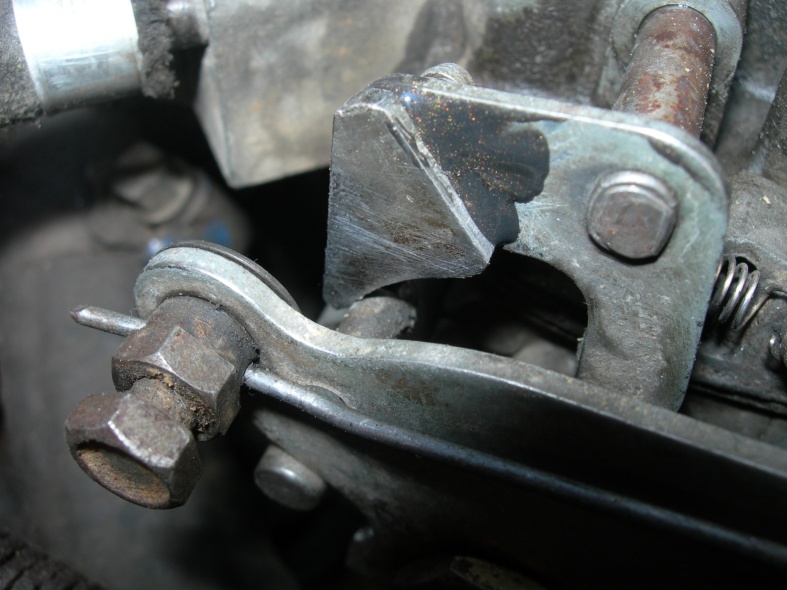

With regards to the adjusting screw for the second throttle valve, I've attached a photo.

The adjusting screw for the closing position of the secondary butterfly on your carburettor still has the 'anti-tamper' cap intact, so the top of that needs to be snipped off and the screw backed off about one turn.
If you cannot track down a replacement roller for the accelerator pump lever, the cover & lever from an 18/26 carburettor can be substituted, but make sure that spring inside the chamber doesn't escape...

Sorry, I forgot to ask. What is the logic behind backing off the adjusting screw for the closing position of the secondary butterfly by one turn? I was always under the impression that this setting was set at the factory and shouldn't be disturbed.
Regards Paul
Regards Paul
Re: Carburetter Identification
Paul,
just the realisation that, after many miles of use, the original setting is no longer effective because the butterfly will have worn away its seating in the bore.
Experience has shown that one turn back on its stop screw usually restores the seal.
If you want to put it to the test, try pouring some cheap engine oil into the secondary barrel with the engine warmed up and ticking over.
If the oil rests on top of the butterfly, there's no problem.
If it's drawn through straightaway, adjustment is needed.
