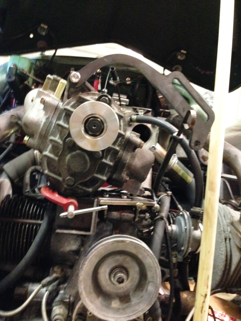

This method worked well using an M10 tap yesterday, when I snapped the tube whilst trying to rotate it 180 degrees on my Avion. I cut about an 8mm depth of thread, screwed in a short piece of M10 studding and jacked it out
Why was I trying to rotate the dipstick tube? The answer is in the images I've hopefully managed to attach

Is that an Aisin 300. Well done that man. Is it going to go under the bonnet or will it need a bulge.
