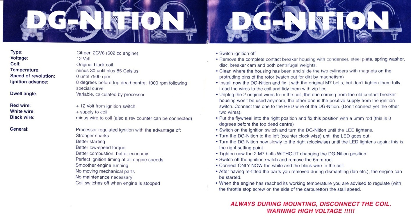

Hi again, a bit more info on the DG... NOTE: Disconnect the battery first. the DG unit replaces everything including the bob weights and condenser, 2 small magnets are pushed onto the pins where the bob weights normally pivot, the DG unit is bolted on using the 2 timing bolts. Connect up, remove the spark plugs, turn the engine over and push your timing rod though the crankcase into the flywheel re-connect the battery then switch on the ignition. Turn the DG until the light comes on turn the other way and at the point where the light goes off, turn back until the light just comes on and lock the bolts. Put the plugs back in and that's it...
- DG-NITION instructions
- DG-NITION.jpg (351.82 KiB) Viewed 18208 times
