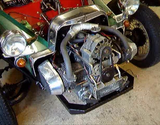

Is it the standard 2CV oil cooler or a Mocal unit? I've used plumbing compression fittings on the Citroen cooler after cutting off the original fittings.

I must learn to read previous posts before posting my own..Cambridge.
I have the standard 2cv cooler with cut off pipe so 10mm plumbing compression fitting does sound like the way to go.

Post by howardjs » Mon Apr 28, 2014 11:54 am
Or you can use pneumatic compression fittings they obtainable straight or elbow compression to compression or compression to hose tail or banjo, pretty much anything. just Google Enots they are sold by many air and hydraulic equipment suppliers.
The pictures show 10mm OD elbows connecting chopped off aluminium cooler pipes to 10mm copper central heating pipe.

Post by Geoff Ryall-Harvey » Mon Apr 28, 2014 7:12 pm
Yes - pneumatic fittings would have a much greater range of adapters and they can be had in brass, nickel or stainless.
