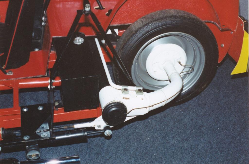

Here's a photo of the original 223 exhibition car showing the tank, but not the vent unfortunately.
Cutaway Lomax
Cutaway Lomax

On second thoughts, your tank may be slightly larger than the 15l standard as it extend beyond the chassis rails a little. I believe that the original Lomax tank lined up exactly with the chassis rails (as in the sectioned photo) for safety in the case of an accident.
