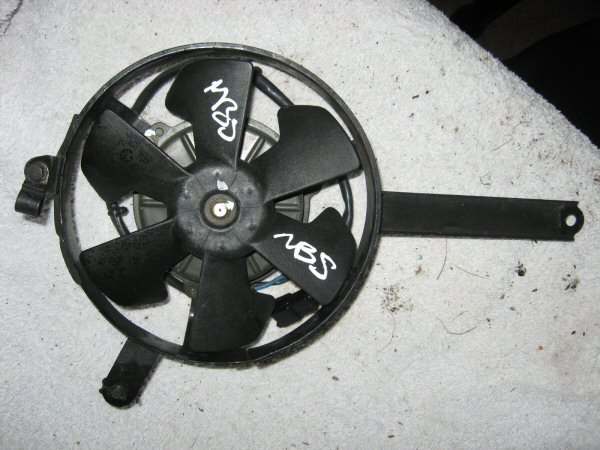

The Yamaha fans on my Lomax are similar with the enlarged outer 1/3 of the blade (see below). I didn't realize this was for added performance, but good that it is..... Kevin
Right Fan Front.JPG (70.59 KiB) Viewed 12739 times

Well got the two fans. Will this make it a KWACKERMAX ?
Did a location-by-cable tie check to see if it would all work. It does!!! I am going to drill and tap some location points for the fan frame as I just don't trust cable ties as long term structural members! The fan is actually running in these pictures but the camera freeze frames the blades well. I did a meter check on just this one running & it pulls a steady 4.3 amps. So, 8.6 amps for two across a switch. Relay required really.
I notice my Kawasaki blades number 8 and you have six. As long as they work eh?

Looks good.... we now have two Lomax hovercrafts. Your engine compartment looks very clean and well manufactured. I find that even though there are quite a few chassis and other obstructions the actual air blast over the cylinders is quite substantial.
Kevin
