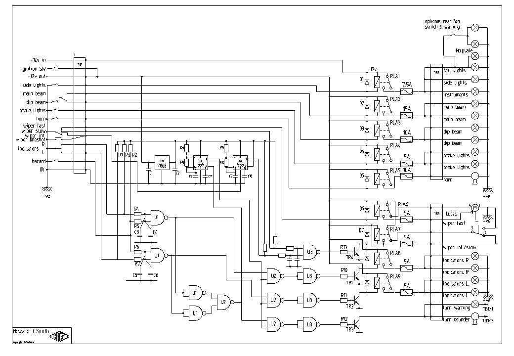

Re: Wiring Diagrams
Hi, Yes Callum is absolutely correct. There is no way of knowing how many loads are on a particular fuse without pulling each one in turn to see what stops working. It may be for example that all side lights are on one fuse or the front and rear may be on separate fuses. Or the indicators could be separate left and right or all together with the hazard circuit.
For example if they are all together then 4 indicators at 21W + 2 side repeaters at 5W makes 94Watts /12 volts = 7.83Amps. In this case a 10 amp fuse would probably be chosen, presuming that standard filament bulbs are used. (I have since changed to LED bulbs and need to update my fuse ratings).

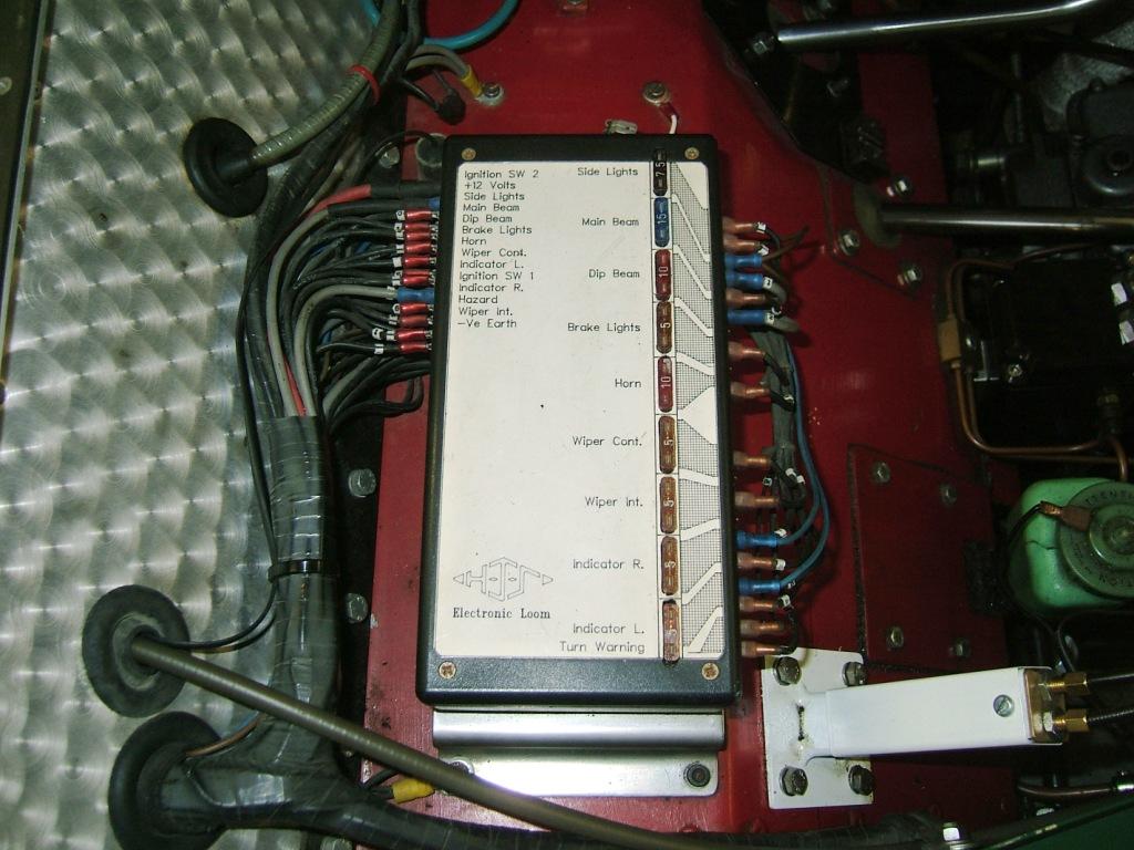

Anyway at the risk of inviting criticism and ridicule here is the circuit of my car showing the fuse ratings for each load, it's been in use for 8 years with no problems so far. The "control box" contains a line of relays and fuses with some CEMOS logic to sort out the indicator flashing and hazards also the wiper motor control.
