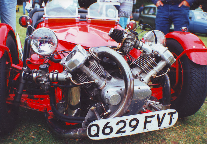

Im will give it a go with fans and additional oil cooler the picture on google of tarkus magma is as it looks now other than engine it is now fitted with gsa gearbox and gsa 1300 engine thanks for all the sugestions car should be on road by march 17 i will post some photos cheers bryan
Re: Gs engine best way keep engine cooler
Post by howardjs » Sun Nov 06, 2016 2:13 pm
Re Tarkus Magma... see website, vintage thing 106...What an engine...!
Magma 1.jpg (187.4 KiB) Viewed 18579 times

Post by 1bigdog » Sun Nov 06, 2016 5:38 pm
Ive just seen my magma picture and yes it was some engine i got car without engine i did plan putting a v twin ss motor in out of one my bikes but citroen gs it is as its running citroen subframe and gearbox now engine so its a citroen special we will see cheers bryan
