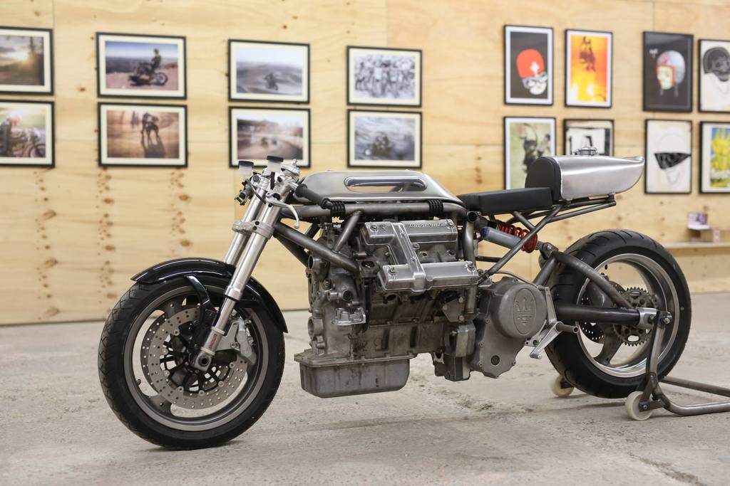

I'm building a citroen engine (SM) motorcycle but I'm struggling with the choice of coils because I've done away with the distributor.
I think I can use two pairs (8 outputs total) of 2CV 6volt coils, each pair wired in series, one pair per bank of three cylinders, this would mean one coil output would be redundant in each pair
The questions I have are:
1- What is the primary and secondary resistance of a 6 Volt coil
2. I notice the coil is bolted together; can I remove half the coil so I only have one output?

The problem I have is that the engine is odd fire, each cylinder in the row of three fires 120 apart but the banks are 90 degrees out of phase, this means I can't use a single ignition, unless there is some clever programmable system to allow for the odd firing.
It's like running two laverda or triumph triples 90 degrees out of phase. I think I will need to use two ignition modules, one for each bank but I don't want to have 6 coils, I'd rather have 4; 1x dual and 1x single output for each bank, wired in series and driven by one module each, I'm thinking the 6volt coils in series will have a similar resistance as one 12volt coil but I could be barking up the wrong tree.

Ken, thanks for all the info, I'd looked at the Pazon but they are expensive and I'd still have to chop it
I wish my electronics knowledge was better because they are selling Boyer BSA triple modules for £70 on ebay but I'm not sure I can make the pick-up coil plate to hold the two pairs of pick-ups required to drive two modules, they're may be a way to trigger it with a single pick-up.
What I have got at the moment is a 90's Ducati ignition, this came as standard with two pick-ups, one for each cylinder, each driving a module, the pick-ups ran off the crankshaft spaced at 90 degrees, I now have this setup running off the camshaft (half speed) with the coils spaced at 45 degrees, the trigger wheel has three lobes instead of just the one on the ducati. My main concern with this setup is that the extra coil may blow the modules
There is a Czech company that makes a module to replace the pair of Ducati modules and works with the pick-ups, it's also programmable where as the Ducati modules use the width of the trigger lobe to determine advance.
I got to look at the 2CV coil and they are massive, I will use 2x pairs of dual outlet motorcycle coils like you suggested.
