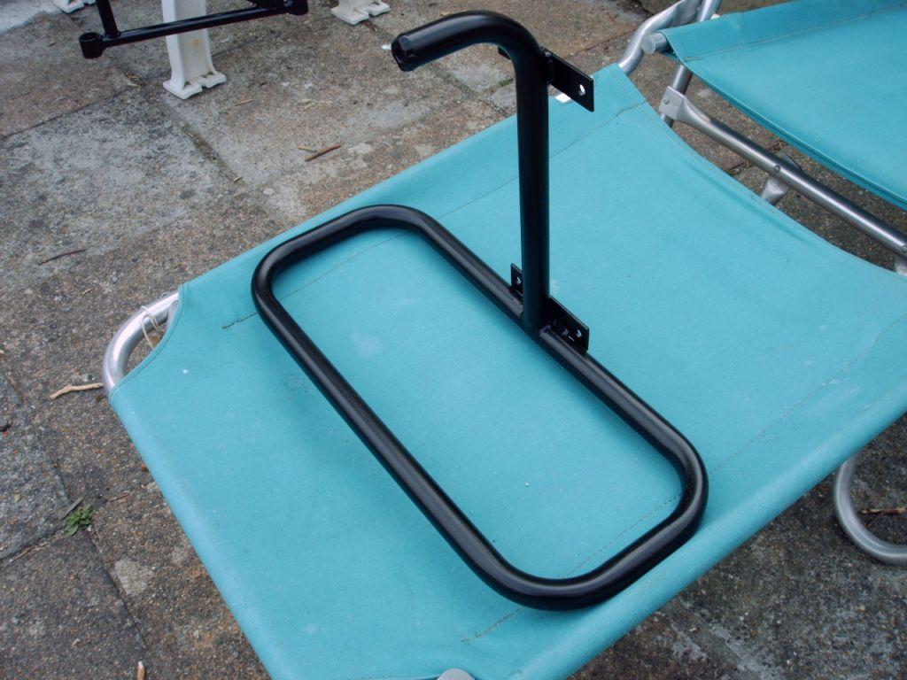

Currently I've got a spare wheel holder on the side of the car that is 2 "J" stcks bolted to the car with an up-side down "Y" shaped leather strap holding the wheel on.
Not very happy with it, as the top strap has broken and I have had to "bodge" it together.
I've looked at a different type of holder that appears to be a round ended oblong shape which the wheel sits in but there are no straps, so I presume that the wheel is bolted in somehow;
Is this through the body or onto a vertical bracket from the bottom of the mount?
How does the whole thing mount to the body?
Any one got a photos they can show, please?
Also dimensions if possible?

Graham,
dims to suit wheel, m12 nut in end.
fixings align with scuttle hoop inside tub.

Thanks Bob.
Big favour; could you measure the external dimensions for me, please?

Post by cmwbob » Thu Jan 19, 2017 7:49 pm
see drg
spare wheel carrier-1.pdf
(8.43 KiB) Downloaded 687 times

Post by cmwbob » Thu Jan 19, 2017 7:56 pm
Graham, I have two different sets of rollers and have different drgs for each. You will have to suss your own cutting length and bend start points to suit whatever roller/pipe bender you use.

Post by llanigraham » Thu Jan 19, 2017 8:20 pm
Thanks Bob. Intention is to use the bends that are already fitted, so that will help.
