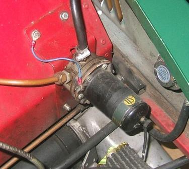

Or fit an electric pump. This is a refurbed SU as fitted to Morris 1000's etc. but there are several aftermarket pumps available from the likes of CBS etc.
Works perfectly and with a reassuring clicking sound when you switch on the ignition, no moor engine cranking needed.
