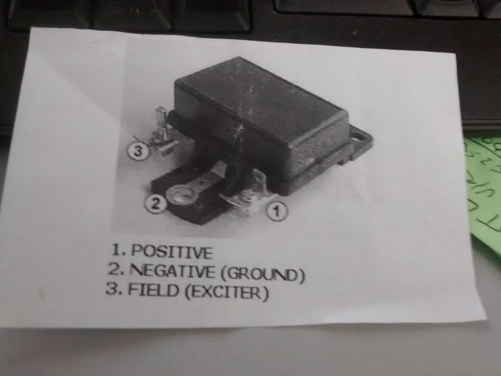

Keith, is the reg one of these pictured, i have fitted some and they have controlled ok

Post by kgnoble » Thu Apr 18, 2019 11:20 pm
Yes that's the one that went bad. I now have a replacement from ECAS....but the old original (and electro mechanical) Dyane one seems to be working well. The car was up on the ramp for the MOT with the engine running for about one hour and seemed to be regulated well
The one from ECAS is specifically for the Dyane. Any ideas why?

Keith, just a thought on your regulator overcharging problem. Maybe it was not earthing effectively on centre tag, that would give the reg a false reference voltage from which to control the alternator.

Post by kgnoble » Sat Apr 20, 2019 5:08 pm
Thanks for that thought.
Yes, I put a separate earth straight to the battery to test, and the regulator still failed. So I think for the moment I will stay with the Dyane regulator - and keep the new replacement in the glove box :-)
