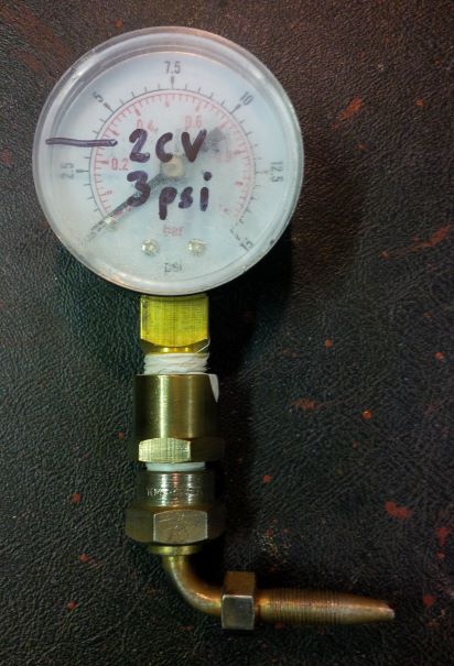

I am not sure that a gravity feed will give accurate results as the carb is designed for 3psi, gravity feed carbs use different float needles.
Might be worth checking fuel pressure, I had the bizarre problem of carb flooding after I switched off engine (easy to spot on a Pembleton).
I checked fuel pressure (new pump) it was 5 psi rather than the recommended 3 psi, so I made a thicker pump to engine gasket (you can buy these from Der Franzose). Tested now 4 psi and no flooding but carb too weak on tick over.
A 0 to 15psi fuel gauge is less than £3 on e Bay including delivery from China, a 1/4 BSP to 6mm adapter is another 99p (I had an adapter in stock), at these prices worth testing pressure to see if is too high or too low.
