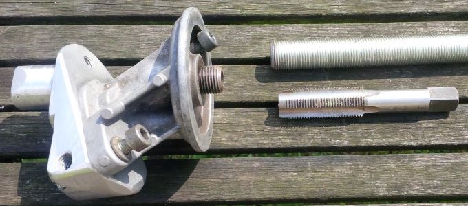

Attached photo shows the fixture I use on my lathe for machining a 3/4 unf thread in a 2cv filter head,
- Oil filter fixture Thumbnail.jpg (90.28 KiB) Viewed 7528 times
