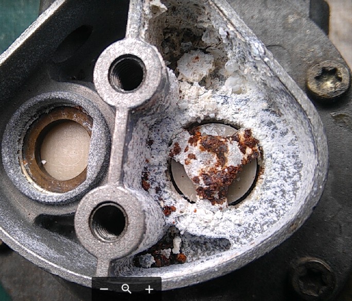

Have you popped the lid off to check for any 'white furriness' in the bowl, which sometimes happens when a carburettor has been badly stored?
In extreme cases, those deposits can block the emulsion tube, as my friend in America found when the only way he could drive his 250 van was with the choke partially on. :(
I destroyed one single choke carburettor trying to remove the brass plug above the emulsion tube, so now that I've stopped servicing, but still have quite a stock of parts lying around, I've got hold of an ultrasonic cleaner as a first line of attack when refurbishing carburettors.

For information see what the white furriness can be. I though I had a spare petrol pump que nenni it was blocked by the white furriness. Amazing is it not?
Ken Hanna wrote: ↑
Tue Aug 27, 2019 7:01 pm
