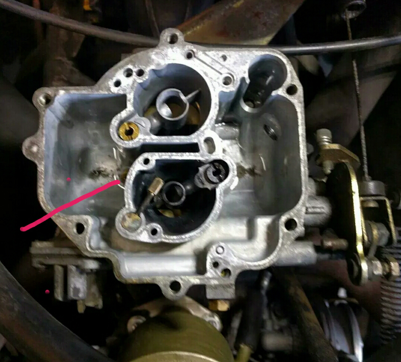

Re: Cant help myself
Hi Ray
I am not too sure what is the jetting you'r missing attached a picture for the second jetting, follows the red line....
But I think prior to start with this or this you should do some reading to better understand how it works try to see what has been writen by Ken Hanna on the Subject. . Carby's are very sensible part of the car.. worth spending some time on it..
Cheersy
Cheersy
