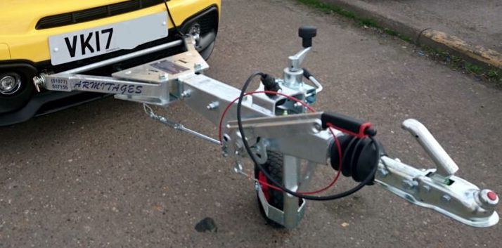

Amitages for example make an A frame with braking. It uses a braking towing hitch connected to a crank lever which in turn pulls a cable which passes through the front of the car being towed and through the bulkhead where it is connected to the brake foot pedal...

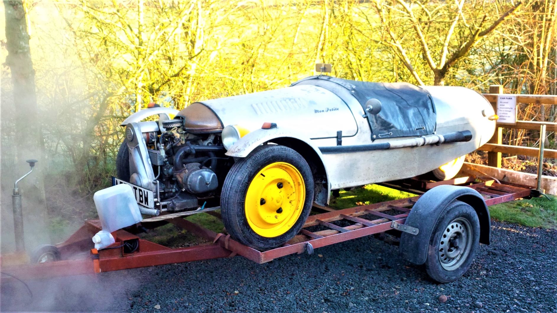

I use a lightweight un-braked trailer just large enough for my special, easy to tow, no legal uncertainty and useful for other tasks.

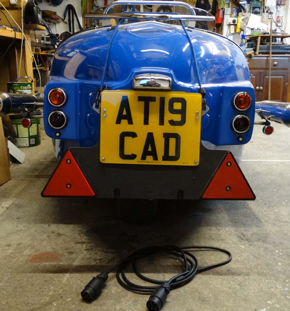

The coupling is Alke Pole Coupling 700-1000kg which I sourced from FS Trailers in Huntingdon 01480 453333 (there are other dealers) for £210 + vat.
The spring on the auto brake is so strong I had to make a limit stop (black angle piece with adjuster) to prevent damage to bowden cable.
Light board hooks under the rear body and fixes with a bungee. Number plate light still shines on plate, triangles lower than rearlights.
