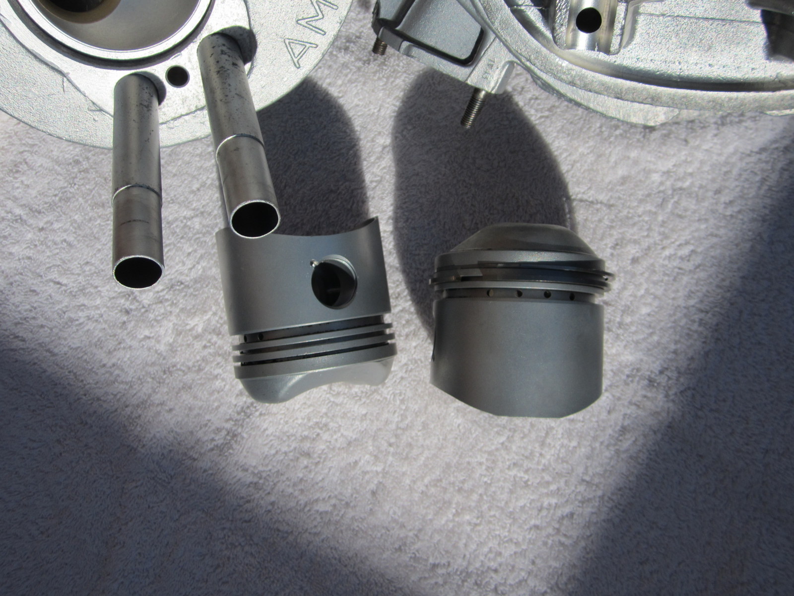

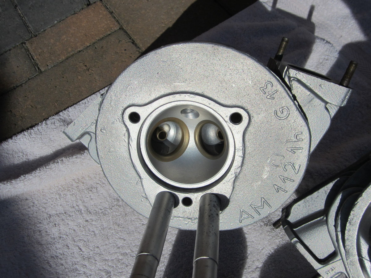

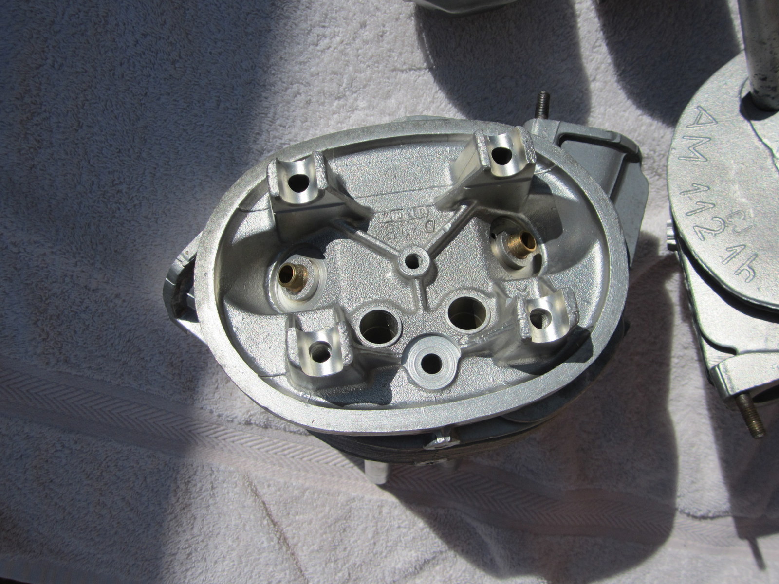

Finally I found some pictures of the heads after they had been vapour cleaned, and the pistons. I re-assembled the engine using new rings, after honing the barrels,(M8 Cap-head screws as suggested by post on here, replacing the Citroen 6mm peg ones) the pistons cleaned up and showed no signs of abuse.... all ready for my first run in July .... Thanks for all the input regarding head/barrel separation.... hopefully I won't have to revisit the problem again (ever)
