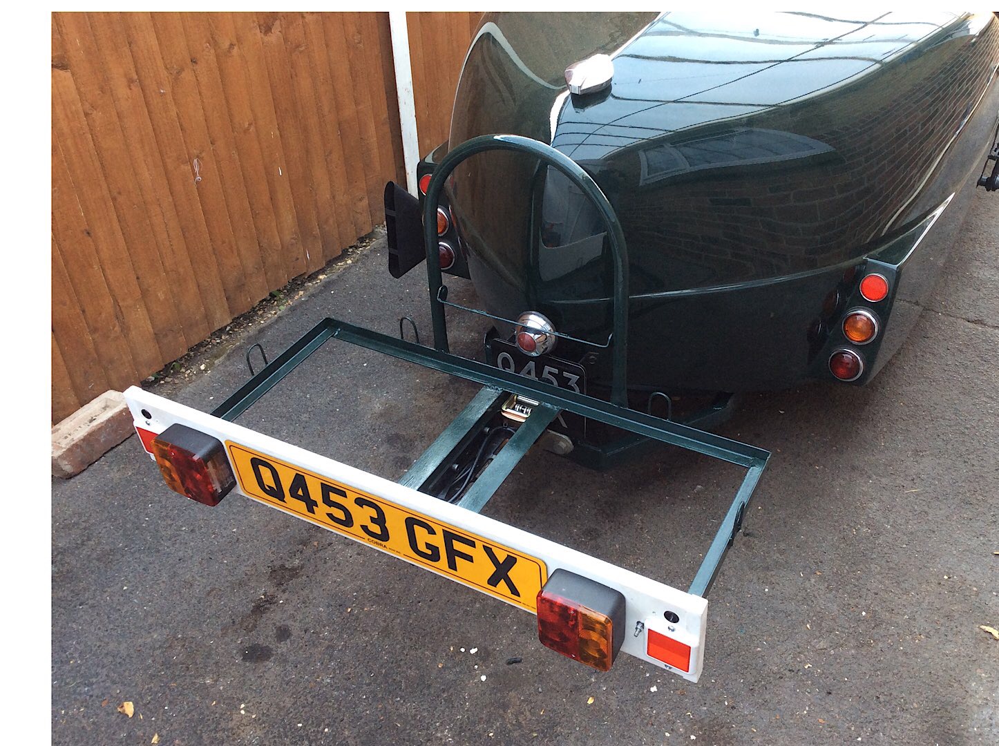

Post by Claus » Fri Mar 19, 2021 11:42 am
Sorry, better picture:

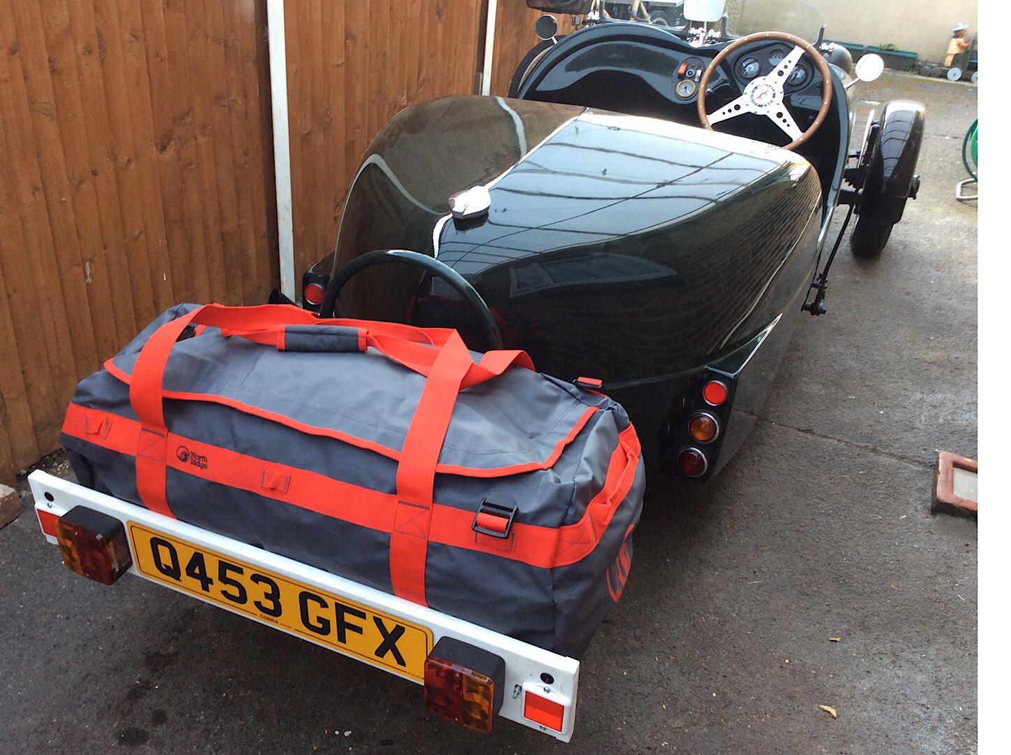

Many thanks for the detailed explanation and the pictures. The travel limiter 'bump-stop' (to restrain the down wood travel of the swinging arm) is a simple solution.
Perfectly clear now and I like your luggage carrier - allows good rear observation, much better than the usual rear boot carrier fitted to QFAD and most other Lomax cars.

Now that I've seen the larger photo of the frame 'in situ', posted by Claus, the frame for the towbar appears to be fixed to the chassis rails at an inlined angle from the lower edge of the rails & not parallel to the rails or the ground ?
It appears to follow the line of the rear bodywork πŸ€”
As there are no 'fitting instructions' with the technical line drawing :-
( kindly sent to me by Claus & which I will try to pass on to anyone who needs them --- with Claus's permission of course --- once I've figured out how to get them from this ancient iPad & into the forum or a pm/ email )
I can only assume that the rear bodyline is the 'guide' for fitting πŸ€”

For optical reasons, I have adapted the course of the towbar to the line of the body.
