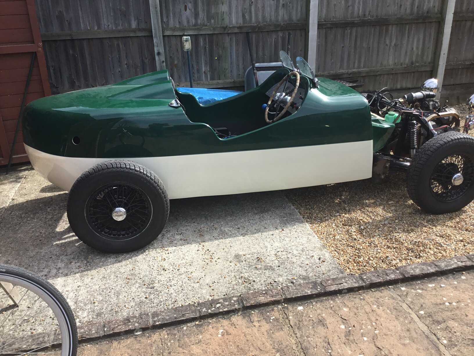

Re: Lomax ride height
Hopefully this will load some pics of my Lomax 224 Special project. Still not sure on ride heights, so if there is anyone in Kent who has a 223 or 224 and would be prepared to let me have a look and take some measurements, please get in touch.
