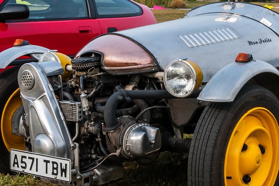

I painted the Citroen manifold with "Granville Cylinder Black" & touch up each Spring.
Pembleton SuperSport
reindeer inn Aug 2020 cropped (2).jpg (184.29 KiB) Viewed 10803 times

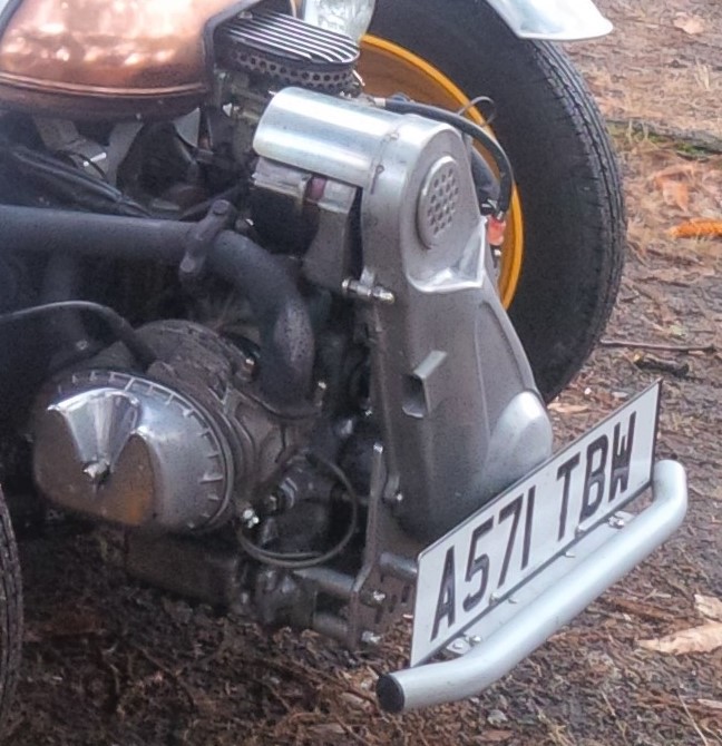

HI Jack can i purchase a Alternator and fan belt cover like yours regards Roger
Joined: Fri Jun 16, 2017 2:22 pm
CSC Membership Number: 2130
Region: Yorkshire
Re: Exhaust bandage
Post by Jack602 » Tue Apr 06, 2021 7:18 pm
Roger,
My fan belt cover is a transmission casing from a Honda Dylan scooter.
I purchased mine from a scooter breakers, Black Knight, in Stainforth, Yorkshire, they had several in stock.
Cover France 2019 (2).jpg (143.92 KiB) Viewed 10796 times

Hi Jack. Very much like your alternator/belt cover but it appears to obstruct at least 50% of your oil cooler! 🤔
