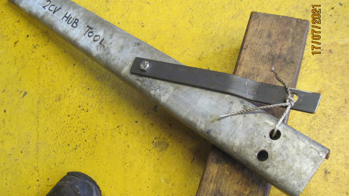

To restrain the suspension arm when loosening or tightening the hub nut I made a tool with a piece of heavy section channel (about 2 ft long) drilled near the end to fit a wheel stud and a steel strap (about 10" long) between a different wheel stud and that channel.
I tried to attach a photo but the file is too big ?! - Is there a way to overcome this ?
The tool works well - I wish it had been my idea.

Re: 2CV rear hub removal
2cv hub restraint tool
- 2cv hub tool.JPG (384.73 KiB) Viewed 10063 times
Apologies but I've posted a red herring ! That tool I suggest for restraining the hub works for the front hubs but not the rear hub because the hub nut for the rear hub clamps the bearing inner races to the swinging arm - not the hub and brake drum.
So to undo the hub nut to remove the rear hub the swinging arm needs to be restrained eg by using a scoffold pole as notsmartcar above or in my case I confess to using stilsons to grip the suspension arm just behind the brake backplate.
