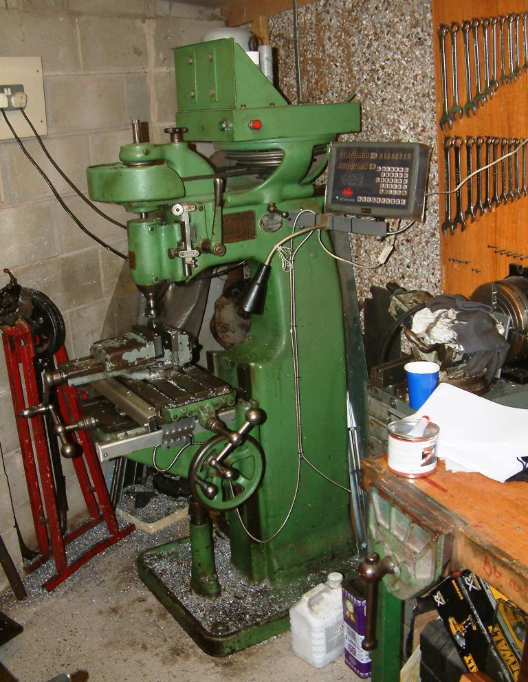

Post by howardjs » Tue Apr 20, 2021 11:48 am
Hi Vyv I'm trying to post pictures but this site keeps logging me out
My machine is a Reed Prentice, American ex WWII, I've had it for 30is years.
However I would think that if you were to do the prep. A machine shop could do the machining for a few pounds.
Or if you would like to bring them over to me I could do it for you.
Reed Prentice.JPG (156.13 KiB) Viewed 18967 times

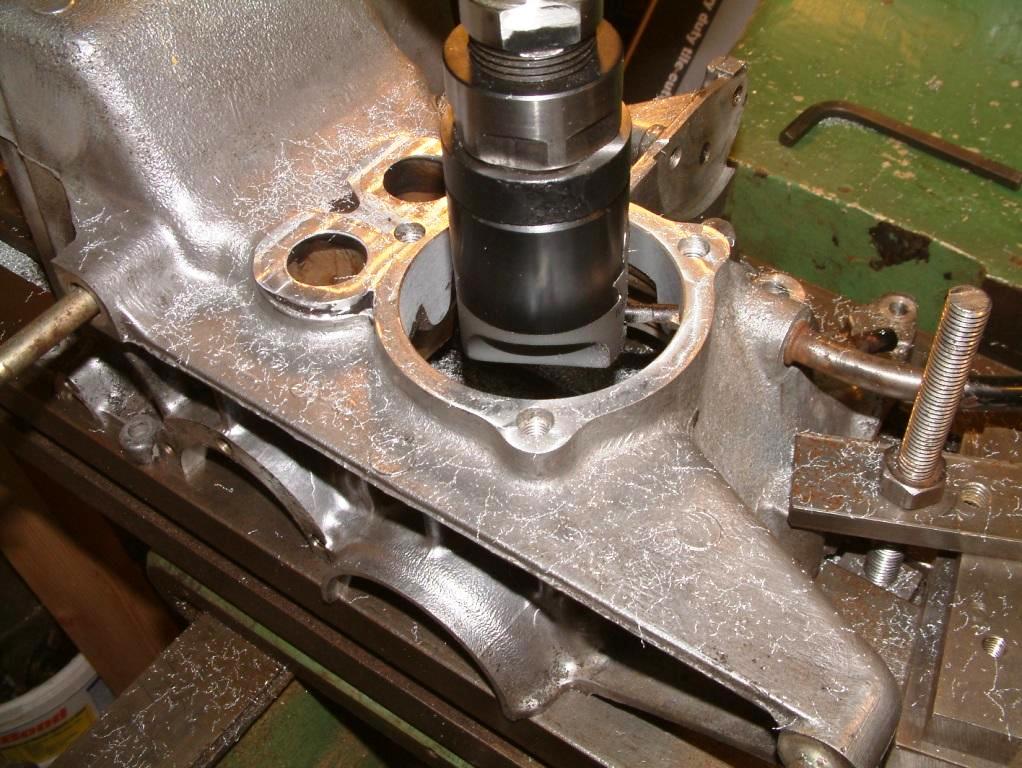

Post by howardjs » Tue Apr 20, 2021 11:49 am
Boring the crank case.JPG (144.26 KiB) Viewed 18967 times
Machining the seats.JPG (134.55 KiB) Viewed 18967 times

very useful information and a most welcome offer. I am now living in France (as is son Owen) but he travels back to UK regularly. Perhaps we can ask you to machine the casings for us when I have made the push rod tube adaptors?

Using the Visa barrels on a 2CV virtual equates to the VGS 652cc Nikasil coated aluminium barrels I had previously - unfortunately they are no longer available due to production costs.
Filip always preferred to use the Visa barrels on a 2CV crankcases as the 2CV engines were manufactured using a very good quality aluminium.
