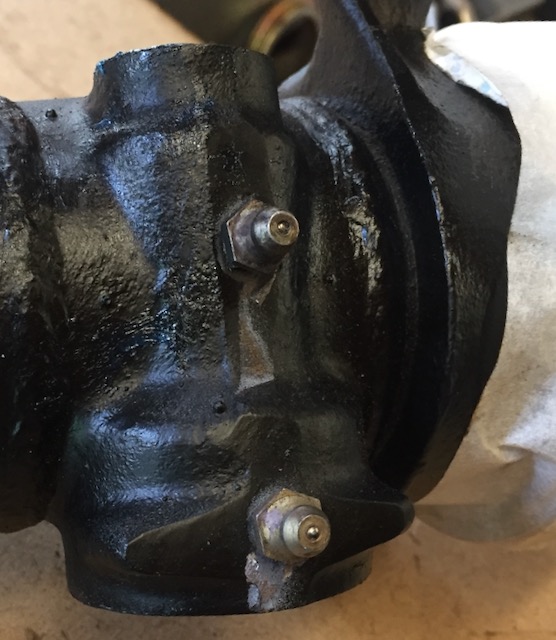

Look after your Steering Rack.
As the rack needed a “rebuild” have added these grease nipples.
1. Steering Pinion Bearing.
2. Steering Pinion.
3. Guide Ring.
The short piece of brake pipe goes the the steering tube into the guide tube.
Grease can be pumped in with the rack at various positions.
