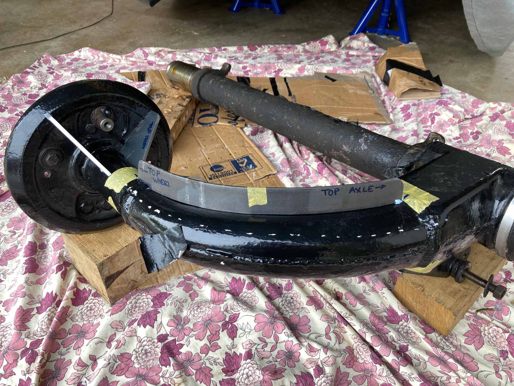

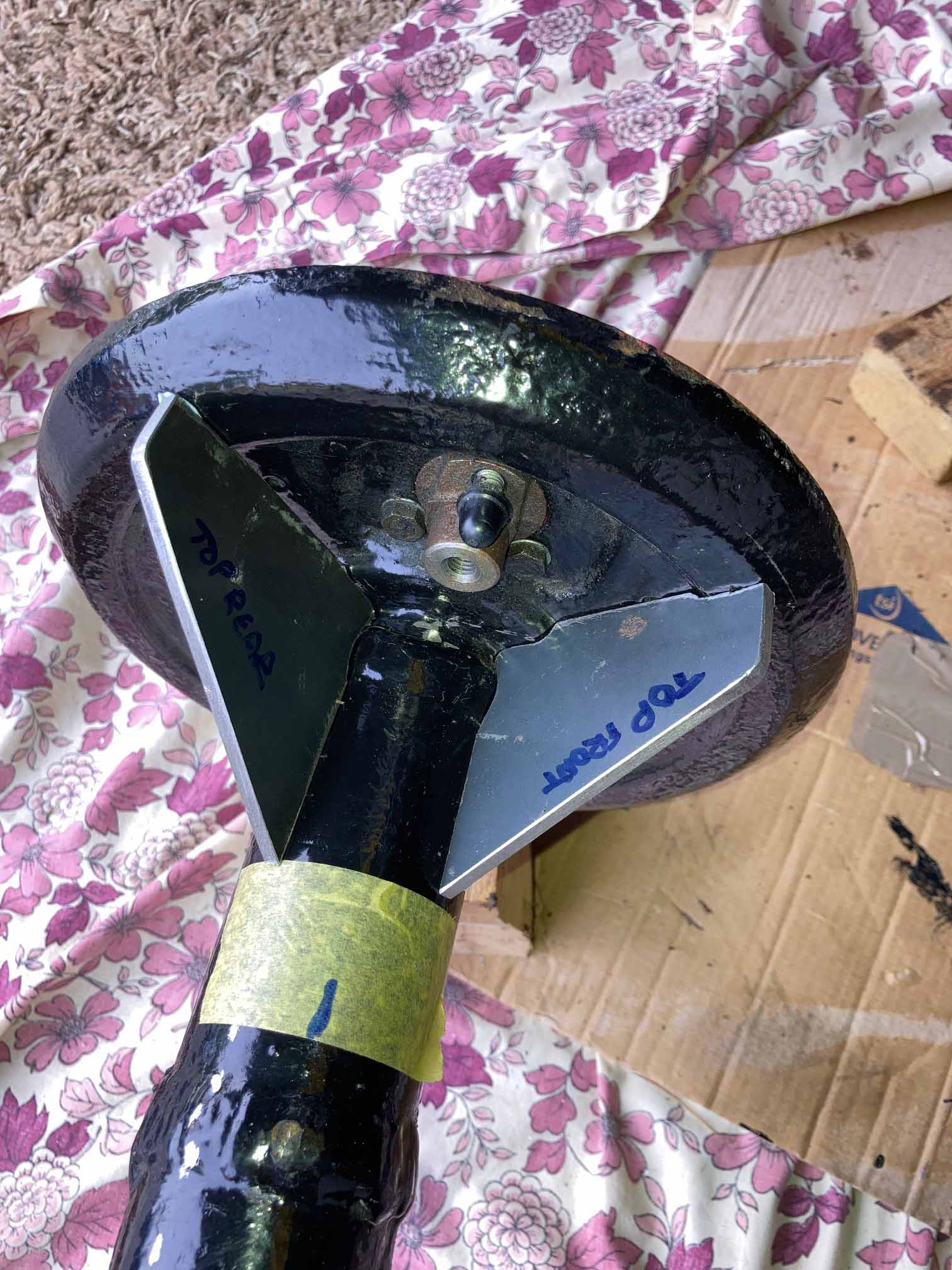

Further to my post 10-April-22, my replacement arm (without any reinforcing) has done about 1000 without deformation at the weld behind the backplate.
However, to try and reduce the risk of deformation I have fitted 3 webs spaced around the backplate. (avoiding brake adjusters and brake line) The 5mm thick webs are welded to the extension piece and then over the weld and onto the short stub behind the backplate.
For good measure the welds then run up the backplate, but I doubt that will contribute much extra strength. ( The original arm that failed had a similar single vertical web underneath and only failed in tracking, but was ok in camber )
Meanwhile I have measured the load on each wheel.
With 2 adults the load on the rear wheel was too close to the accepted unreinforced load, so I have added top and bottom webs to the arm to increase capacity.
Hopefully the arm should be bullet proof now, but then potholes are getting worse…….!
