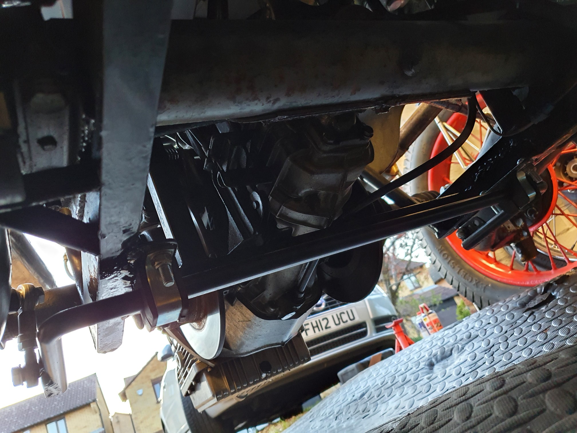

Have now tensioned the rear spring on the redundant side using the original tie rod end fitting and knife edge in a strap secured to the rear of the chassis.
The thread exposures in the tie rods are similar to those on the side with the active rear arm.
The rear spring is definitely loaded as the front and rear buffers now look their normal shape. Previously there was no load on the rear buffer and the front buffer was heavily compressed by the cylinder against the stop as the front spring only was used to get the front ride height.
Regards body roll it has made no noticeable difference & may be slightly worse.
Looking at the suspension design, I believe the 2 springs in the cylinder are acting in series.
Given the 2 springs are similar stiffnesses, then for a given load there will be 2x the compression of a single spring.
So roll will not be reduced.
However, roll turning left and loading the active side of the car is far less, yet both springs are active on that side and the rear wheel contributes very little to resist roll!

Re: Lomax 223 anti roll bar
This video is a good description of how the 2cv suspension works.
https://youtu.be/j7pFxgDmZXQ?si=szoN0nvYLGzlbvsu
Simply putting one of the rears under tension will really muck up you're front spring rates. The two arms are linked to provide equal raise on the front when you hit a rear bump, or vice verse.
Bob has mentioned a few times in this thread that the bar between the rear arms is to equally link front/rear suspension. With only one side linked (whilst retaining floating canisters) you'll like get an odd feel.
The front/rear linked suspension could be "deleted" by fixing the canisters (IE, remove the possibility of the canisters to float) and this would resolve your issue.
On a three wheeler the only thing that controls body roll is the front axle. In this instance the front axle is being affected by the travel of the rear, but without the linked rear arms, the rear suspension load is only affecting one side of the front axle, thus giving different feel in left and right turns.
