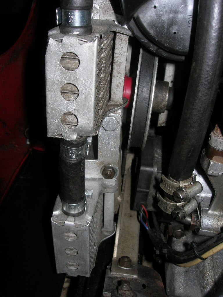

Excellent! Thanks for the pictures chaps!
Is that crankshaft pulley really as close as it looks to those brackets in the pic? :o
Only drive as fast as your Guardian Angel can fly!!!!
Re: Oil Cooler pipe union sizes?
Post by howardjs » Sun Jan 18, 2015 11:34 am
There is 4mm of clearance but its OK coz the cooler is bracketed onto the engine so it all moves together. If I need to gain access to anything its just a matter of removing the clamp bolt (not shown in this pic) slackening the horizontal nuts on the fitting elbows and pivoting the cooler up and out of the way.

Four millimetres? As much as that? Ha ha. Yes, tight fit.
I have just been looking at the front end of mine and remembered I have a few spare parts in a separate part of the workshop. Had a look and found a spare std oil cooler. So a double-up system like in the blue car pic is a distinct possibility!!!

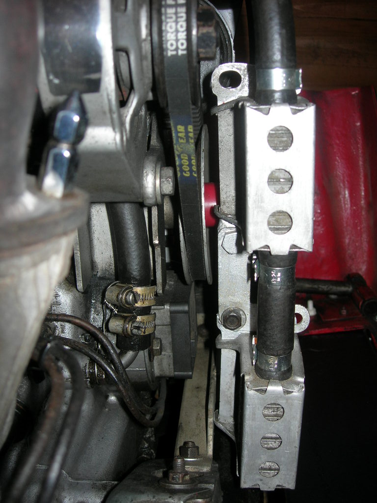

Here my layout with 2no 2CV oil coolers...

Post by Jimmy Cooper » Tue Jan 20, 2015 8:41 am
Great picture. Thanks! Think I'll go that way as I have the spare one and that gives a 12 row total I think.
Have you got a picture of your support 'frame' from the rear for that top oil cooler? I mean, I have been looking at ideas.............but why re-invent the wheel etc. I was going to use two vertical supports off the std support bracket positions plus a steady back to the block but your looks different as I can't see the std mountings in use on the top one so ?
I assume the front of the crankshaft pulley boss is cut off to give the clearance etc?
Thanks in advance.

Jimmy Cooper wrote: Have you got a picture of your support 'frame' from the rear for that top oil cooler?
Attached are a couple of pictures of my double oil cooler support framework. The angle iron at the bottom is what supports the arrangement. In terms of cooling I also have two motorbike fans that I purchased cheap on ebay that blow air from under the car onto the cylinders. I have a single on/off switch for the fans that I user if I am stationary for a while in hot weather, as the oldie Lomax does have a habit of getting quite hot under these conditions. I have also attached photograph of my fan arrangements
