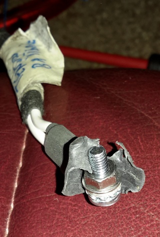

I might be talking to myself but this faulty loom drives me crazy, I have fitted a new battery but no improvement. Best is to leave it for now and go to sleep.

Having spent a good night and paid Burton a phone call, I hope problem is over, that was due to a connection for the ampermeter nut and bolt under a thermocable being undo cf photo.
