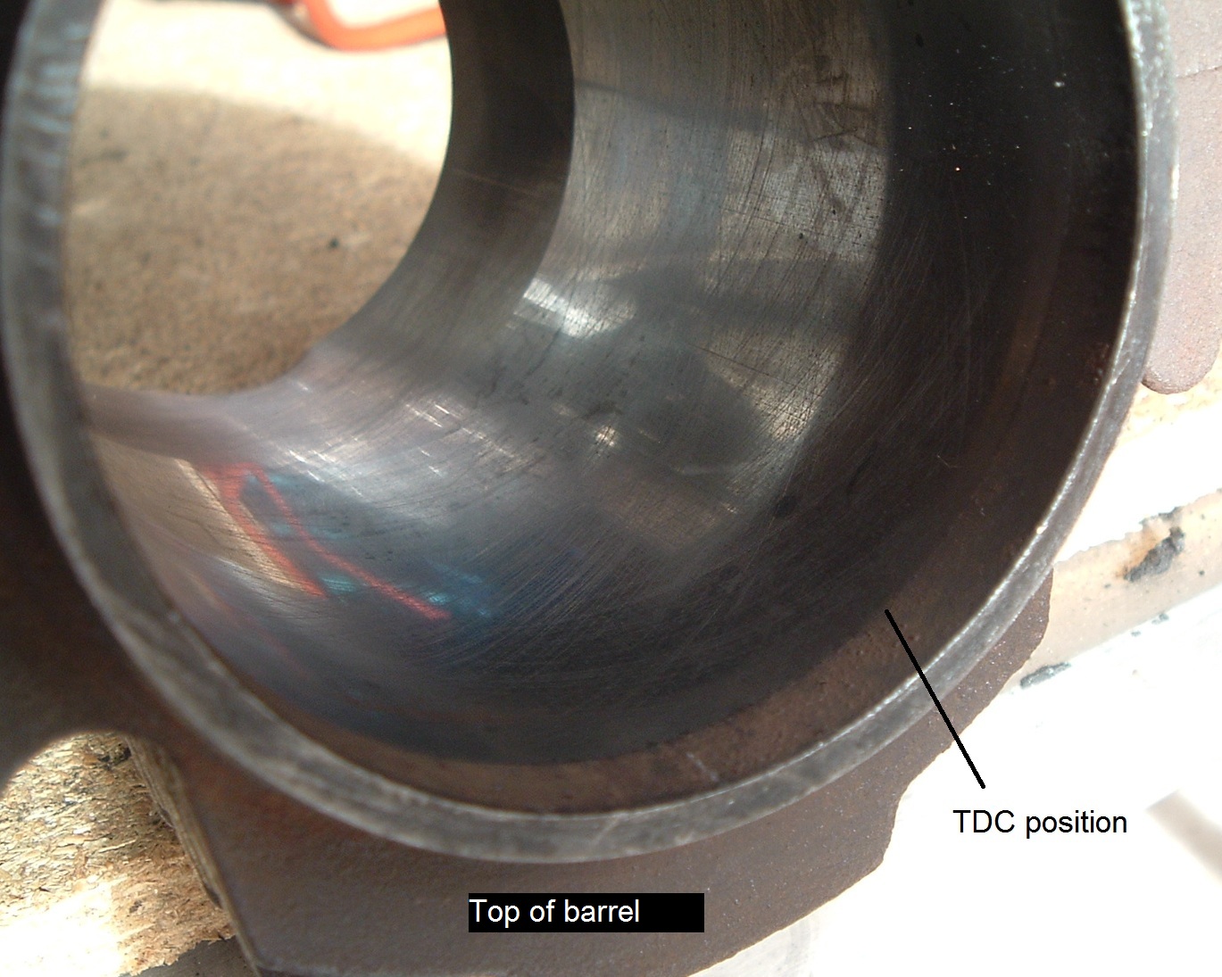

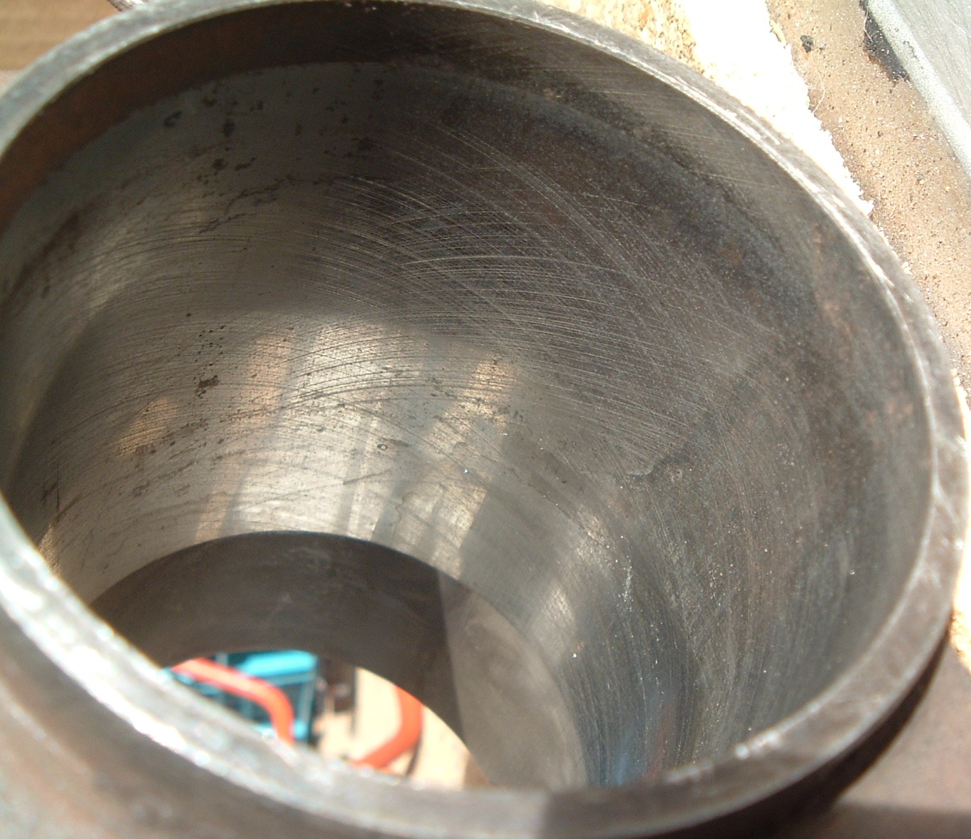

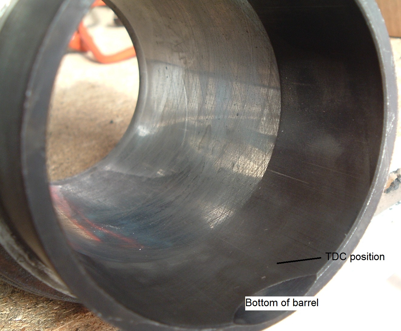

As promised, here are three jpgs showing the state of the nearside barrel:
(a) Middle jpg: is this degree of scoring normal/acceptable?
(b) Top jpg: the top of the barrel, at the TDC position, shows a 'rusty' ridge
(c) Bottom jpg: the bottom of the barrel is nice and flat - no lip
It looks like, during the long period of inactivity, gravity has acted on the piston such that it remained in contact with the bottom of the bore lining; there may have been a gap between the top of the bore lining and piston, where the liner has 'corroded'.
Thoughts?
Thoughts?
(get a new set of pistons/barrels
- Top of barrel at TDC

- Bottom of barrel at TDC
- DSCF5703.JPG (349.96 KiB) Viewed 17643 times
- General score marks
- DSCF5702.JPG (468.34 KiB) Viewed 17643 times

As to your pics Armando - is that pitting on the upper surface of the last photo? If yes it does not bod ewell...

No - on the last jpg what appears to be pitting is actually dust/dirt - but please see the top photo.QFAD wrote:10mm!

Armando,
if I was you, I'd get hold of a cylinder hone and give the barrels a bit of a tickle, then a decoke, valve grind, new stem seals and reassemble with new rings.
The hone, used at slow speed in a battery drill and worked up and down each barrel, will remove that rust which has formed whilst the engine has been standing and give the correct 'cross hatched' finish required.
Note that if you do decide to shorten the barrels to increase the CR slightly, take no more than 0.3mm off the top spigot.
Removing material from the seating at the bottom of the barrel will force the top rings to cross any slight wear ridge, then even the stepped 'ridge dodger' rings which are supplied with some sets won't save things...

Armando wrote:As promised, here are three jpgs showing the state of the nearside barrel:
Thoughts?
