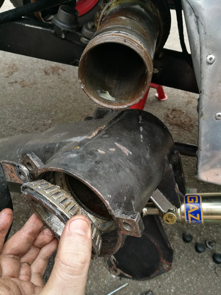

After a bit of a fight, the arm is now out and I can see we’re it failed(see pics) I shall be contacting Cradley motor works in the morning. Thank you to all that took the time to post.
One last thing ...Is this quality of wielding from CITROEN normal
