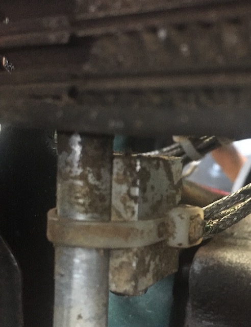

The sump plug solution would only work if you are using a 2cv chassis, as the scrape marks on the plug on my Pembleton testify!
- Reindeer 2022 (3).jpg (379.47 KiB) Viewed 33840 times

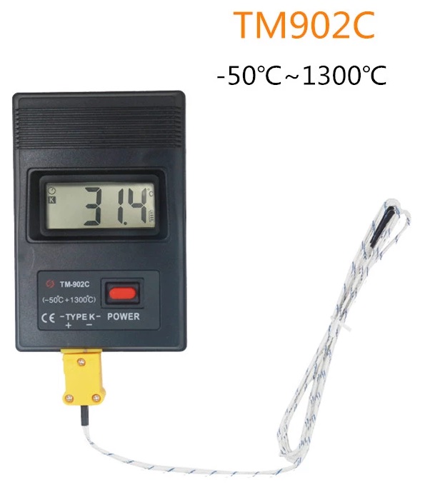

Non-invasive option is to put thermocouple probe on the oil cooler leg (oil filter side).
Measuresment will give an idea as to how hot the oil is after going thru the cooler.
It is battery powered. These simple units cant be connected to the car supply as the TC has the postive leg connected to the metal case ie it is earthed.
Cost with shipping appox £6.
You can obtain "unearthed" TC to replace the supplied item to get round the issue. Cost with shipping approx £7.
The downside is they are digital not analogue
Oil Cooler Display
Oil Cooler Display
