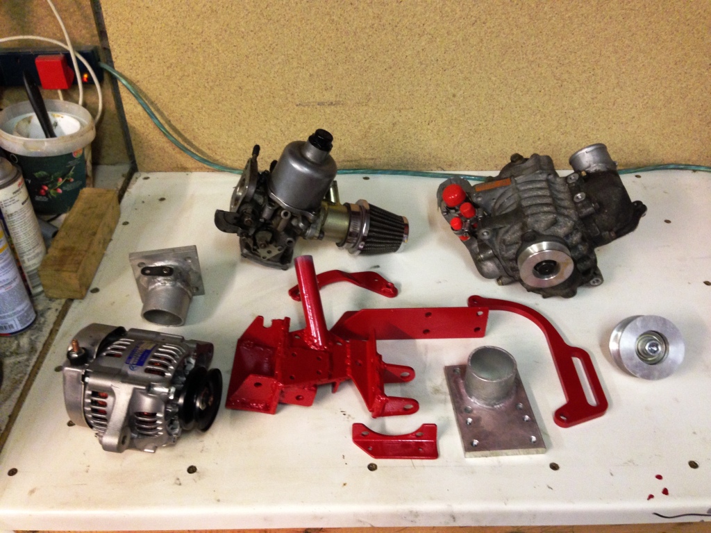

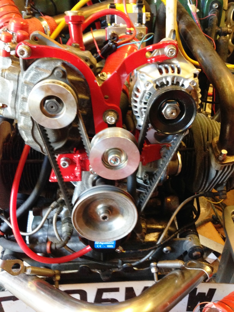

Some more progress in the last month.
I've come up with a "lets see if it all works before doing anything drastic" solution for the carb to supercharger / exhaust clearance issue using some wire reinforced flexible ducting which is supposedly good for 300deg.C combined with heatshield wrapping the offending manifold. This should be good enough to see if it all works well enough to make it worthwhile doing something better.
The prototype 123ignition unit has arrived and I've fitted it in place of the normal ignition, and after discussion with Frank at 123ignition regarding primary resistances I've gone for a yellow super coil. Next big job is wiring changes for coil, ignition unit and alternator with internal voltage regulator. I'm definitely a mechanical engineer by training and inclination, but luckily my dad (builder of the red and white "flying pig" 2cv trike often seen on the 10000ft run) is an electrical engineer.
The 38HIF SU carb has had a new sealkit, and after using the Mintylamb website I've gone for a AAU needle on the basis that the one thing I don't want to be when I fire it up for the first time is too lean. The carb originally had an AAT fitted, which seems very similar in profile to an ABC or ABB. The AAU is richer all the way from needle stations 4 to 15.
Brackets are 95% complete and have been painted, I just need to silver solder a crankcase breather and oil filler solution onto the stub pipe visible on the main combined supercharger and alternator bracket.
Couple of photo's below, one shows the complete parts kit and fabricated brackets, less the yellow super coil. The other one shows the 123ignition unit installed. You can just see the MAP pressure tapping at the lower left quadrant. This is a truly multinational project - the supercharger came from Japanese ebay, the idler/vee pulleys and neat plasma cut curved bracket from Australia, the coil is American, the ignition is Dutch and the carb from the UK - I'm not sure it would have all been possible without the internet.
So once the wirings complete I should just need to bolt it all back together.

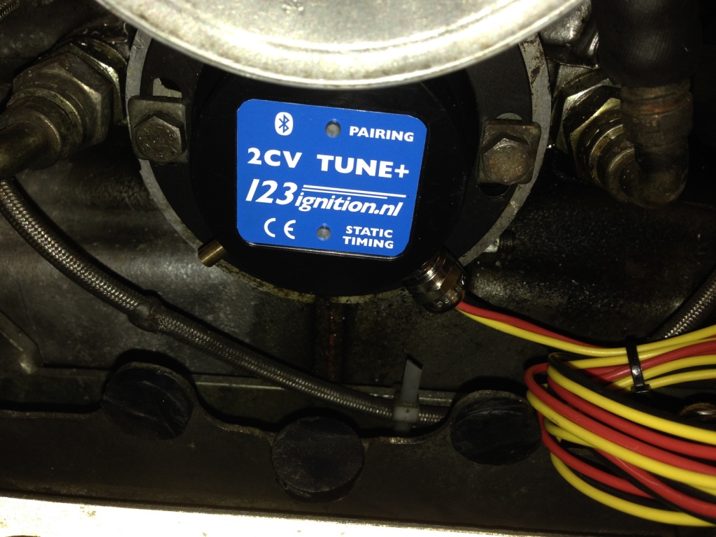

Here's a sentence I didn't think I'd be writing when I bought the Avion just short of 12 months ago
Today I have successfully paired my IPad to the 123 electronic ignition unit via Bluetooth
Re: Supercharged Blackjack Avion
Cool beans.... Can you now create your own ignition curve??
Thats the idea - you can create a normal advance curve, and then a MAP adjusted curve. There are various theories/values for how much you need to retard for 1psi of boost, I'm going to start by using 1.5 degrees as the multiplier (David Vizard rekon 1.1deg. and Alan Allard reckons on 1 to 2 deg.)
But I'm a couple of weeks away from that yet - this was just to see if it connected OK. It did, and on the IPad app "virtual dashboard" the MAP pressure sensor read atmospheric pressure and the voltmeter measured volts - it all seems to work OK so far.

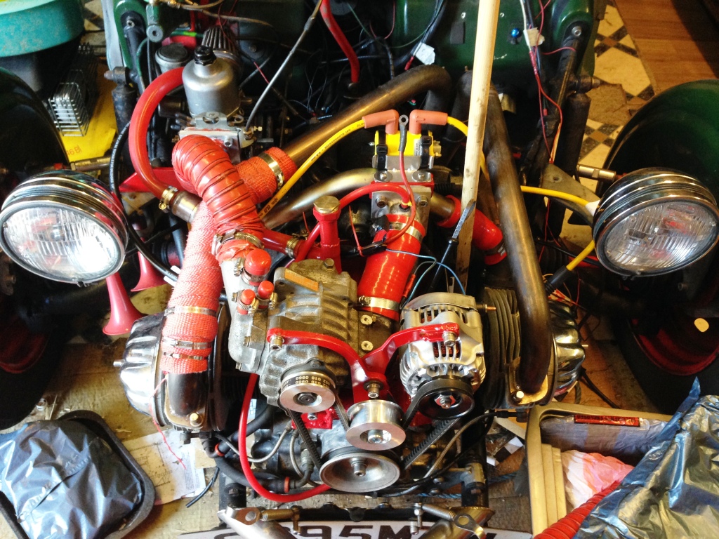

Nearly there - taking longer than I thought but as a wise man once said "its the first 90% that takes nearly 100% of the time and the last 10% that takes the other 100%"
Or something like that - I'm fairly sure that's what Burt Levy's lead character Buddy Palumbo say's with regard to a car project in one of his Last Open Road series of books. Set in 1950's America about a small time New Jersey car mechanic who gets involved in SCCA racing and eventually gets involved in La Carrera Panamerica, Sebring 12 hours etc. they name check Phil Hill, Briggs Cunnigham, John Fitch, Stirling Moss, Fangio etc.. I'd recommend them as light reading for any petrol head (he even runs at Bonneville in one book Geoff - right up your street I would have thought with your liking for rods)

Incredible job of packaging it all in that tiny space. Well done - I'd like to see this running.
I agree about the 90% taking 10% and vice versa.... That the big problem with hot rod building.
