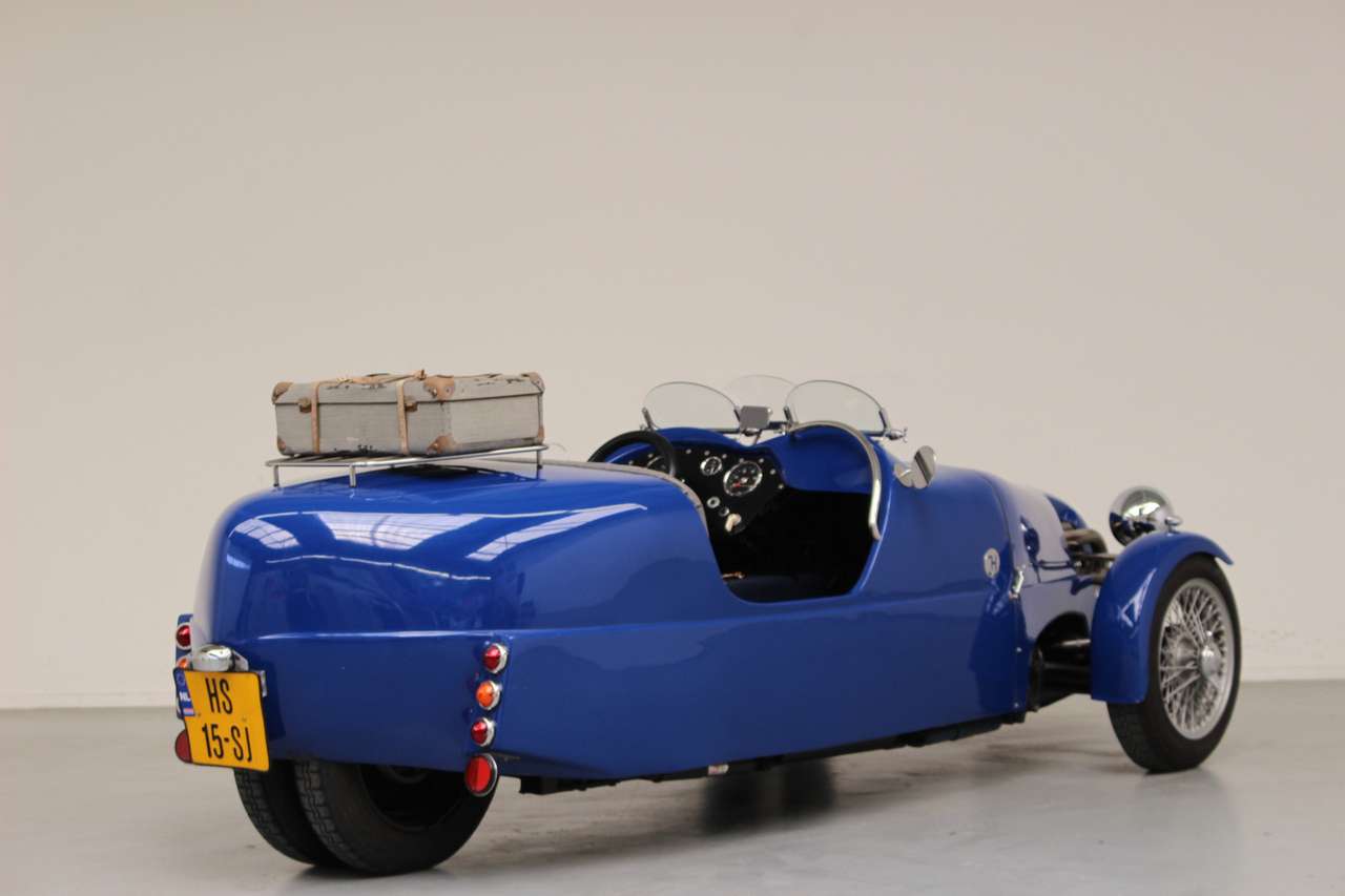

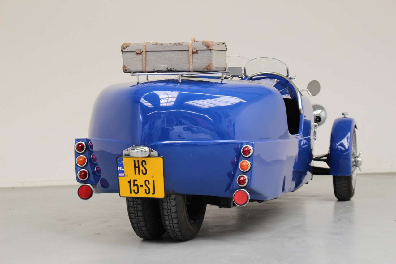

Interesting but it poses another question. I remember reading, in I think the eighties, that a Lomax option was twin rear wheels set close together. At the time that appealed to me and I think that if I had bought a Lomax at that time it is an option I would have chosen. Evidently it was discontinued as it wasn’t eligible for the cheaper 3-wheeler road tax.
Years later as the owner of Mungo (a 224) I cannot see how a standard body would be long enough at the rear end to hide two rear wheels, even though set fairly close together; was the body longer?
So why would I have gone for what is effectively a 3-wheeler with four wheels? The simple answer is I always thought the single rear wheel arrangement looked a bit weak (the Pembleton has a similar arrangement but the rear axle tube is modified and re-located while the swinging arm remains virtually standard) however I appreciate that a Lomax retains a standard chassis. The second reason is I just like to idea of double rear wheels at the back, for a Continental tour etc. it would carry as much weight as a standard 2CV which means you could fit the ‘Daddy’ of all boot racks. Third I just like the look of two rear wheels; if you’re going to be different you might as well go the whole hog!
Finally if any member has, what must be a very rare beast, I would love to hear about it and your impressions of the car.

There are currently 6 twin-rear-wheel "mock" 223s you can view in the register.
https://www.totalrewind.org/lomax
Search for "mock" in the "Notes".
Here's are some photos showing more details of the rear:
https://www.totalrewind.org/lomax/photo ... 23%20b.jpg
https://www.totalrewind.org/lomax/photo ... ar_223.jpg
