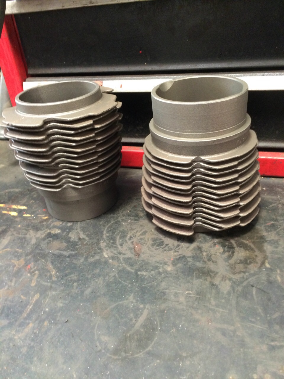

Glad to say that the barrels are looking good:
The grit-cleaner also took off the pitting/rust observed previously in the bore (just visible in first picture).

Hi Armando,
am I right in guessing you haven't done much engine work before?
Just wondering if the cylinder bores have been grit blasted and if so, who decided to take that step, since the hone would have removed that light patch of rust above the swept surface...
Anyhow, after a quick look on Youtube, this fellow looks to have the right idea.
https://www.youtube.com/watch?v=1tiboosuyIc
A variable speed or battery drill makes things more controllable, no need to worry about the drill having a reverse function if the rate of movement up and down the barrel is sufficient to create the correct crosshatched pattern.
Btw, don't get carried away with honing; there was a fellow at the 2VBGB National meeting last weekend who had to arrive in his VW camper van because he'd overdone the job of honing his Dyane cylinders, ending up with so much material removed that the pistons only 'fitted where they hit'.

Ken - Regarding strip-downs/engine building, you are correct in your guess!! In fact, 2CV's are/were new to me - never driven one! But I want a Pembleton - that I build myself. A challenge in all respects... new metalwork skills to learn.Ken Hanna wrote:Hi Armando,
am I right in guessing you haven't done much engine work before?![]()
Btw, don't get carried away with honing; there was a fellow at the 2VBGB National meeting last weekend who had to arrive in his VW camper van because he'd overdone the job of honing his Dyane cylinders, ending up with so much material removed that the pistons only 'fitted where they hit'.![]()
Wherever possible, I prefer to get my hands dirty (with inevitable mistakes) - part of the 'fun' and knowledge-gaining process - this forum (and the Pembleton one), and the wealth of experience, is very much appreciated - I will join the club, proper.
Rather than buy a pallet of bits, I wanted to dismantle a whole 2CV donor car to learn how the components were put together - I've stripped and refurbished most of it myself (with Pete's help/advice on the steering rack and rear hub bearing removal) - next time (a Burton, maybe?) I'd buy a pallet of bits to refurbish, though
Having decided on sticking with the 8.5:1 set-up, I wanted the outsides of the barrels de-rusted and figured blasting would be worth a try as I can always get a new set (with pistons) if they cracked or bores were damaged. My lad did the grit-work - he strips/rebuilds brake calipers for Bigg Red (Worcester) - they use a wheelabrator unit - honing would be the final step anyway, to re-instate the required finish (and hopefully not take too much off). Thanks for the link.
