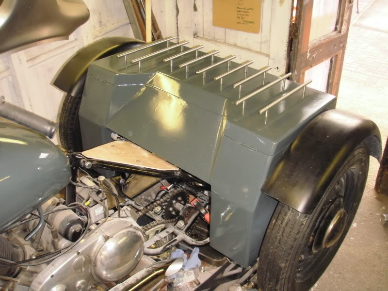

Saw this recently and thought it was a very cost effective way of adding a luggage rack. It's made from IKEA kitchen door handles. They're cheap, stainless and come in various lengths.
[img]ikea%20handle%20rack.jpg[/img]

That's a good, original idea. Would need a very large plate or oversized 'penny' washers at the least to spread the load and stop cracking the fibreglass rear deck of the Lomax range
Not sure about the trikes exposed open chain with no guard. Mind you, if that's the finished machine the rider of this beast is an 'ard man; I mean look at that seat padding.....................not !!!
