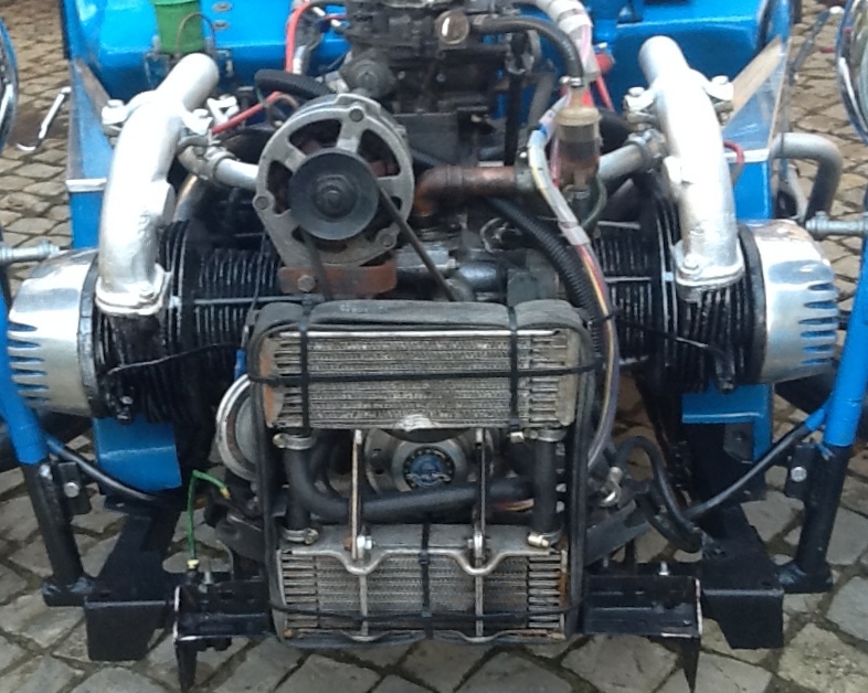

My std set-up is as shown here:-
So, a few more rows can't hurt. This at present shows the pipes attached to the cooler with just the pipes pressed-on and jubilee clips for retention. Works well enough.

Re: Oil Cooler pipe union sizes?
I'm using a 13 row cooler but bumped up the pipe size to 1" and made them quite long. Makes a big difference in oil capacity.
Thanks for the info Geoff. Thirteen eh? Unlucky for some!!!!
Any pictures as I'd like to see the layout ?
Here is a picture sent to me by a fellow member (thanks Aidan)!

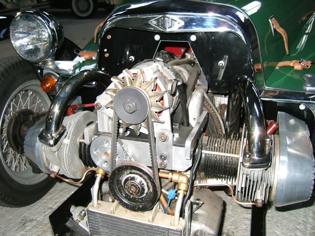

Best picture I have at the minute - the cooler is mounted on the firewall in the disturbed air near the driveshafts. The pipes go up over the gearbox.
For getting round tight corners...
Enots 10mm compressed air fittings...
10mm od to 10mm od tube compression elbow part number 36051106
with 10mm central heating or pneumatic copper tube.
The rad fixing bolt is missing in this pic.
