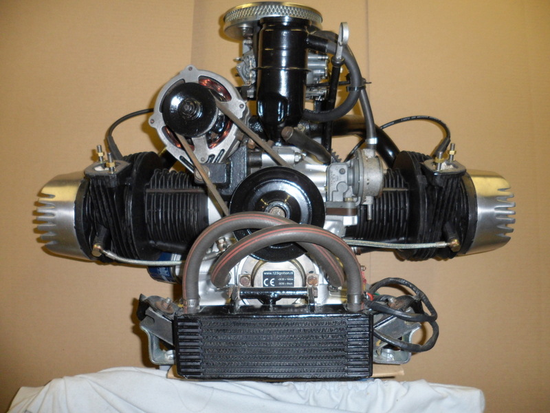

Here is a picture sent to me by a fellow member (thanks Aidan)!
Double Oil Cooler.JPG (213.98 KiB) Viewed 21799 times
