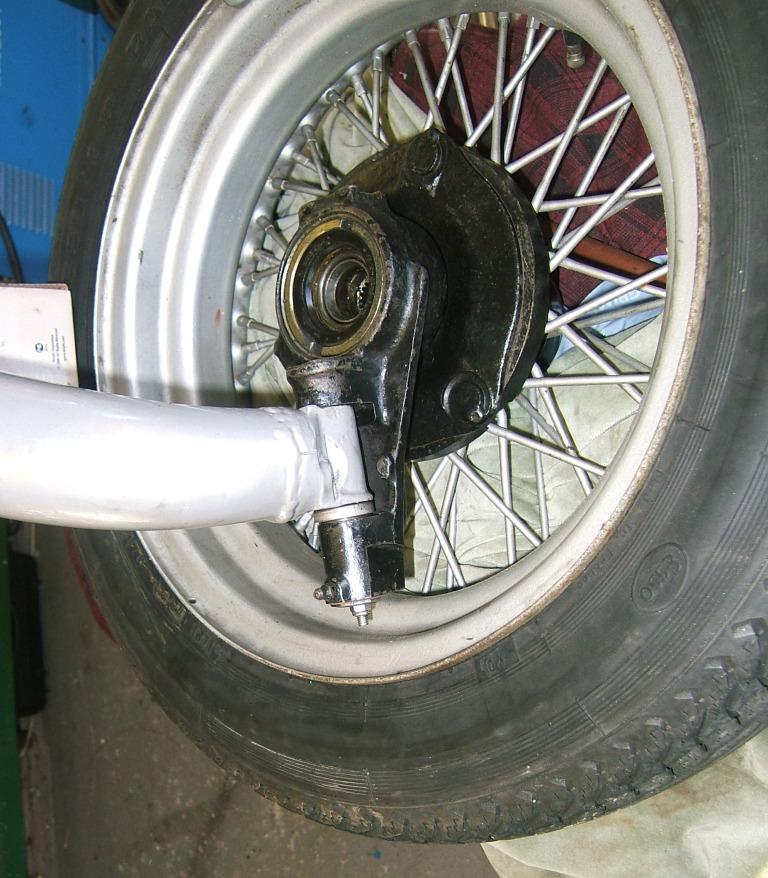

Re: Kingpin greasing
Howard,
With the setup you've got, there's going to be unsufficient clearance between the bottom of the kingpin assembly and the inner wheel rim.
Are you intending to shorten the stud or recess the nut any?
Callum
Callum
Callum, The end of the screw stud will be shortened to eliminate the exposed threads from corroding, however it does fit a wire wheel setup (15") as is. see pic.
If used on a steel wheel then it would need to be shortened anyway.
BTW Your Scotland Frozen North's weather has just arrived in here tropical Cheshire...my workshop heater can't even keep itself warm...can you get Nicy to send us some of your surplus gas? Or a barrel of malt...
Cheers Howard
