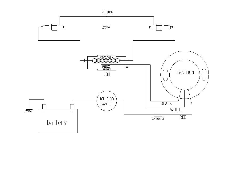

Thanks, all. I have tried the ignition with one plug in the cylinder, still no sparks. Is it possible to test the coil and circuitry by connecting direct to the battery? The system was designed by an electrician, and has no less than six fuse boxes, so you'd have to be a magician to guess what serves what. I do notice that there is a box of tricks marked Type TE305/2 with a rotating knob marked 0-100%, and "Green (timing)" and "Red-timed", but no lights coming on if you twiddle the knob.
Re: Electronic ignition faults
The DG should be connected as per the diagram, there should be no other components involved in this ignition circuit, other than perhaps an immobiliser switch which may be between the ignition switch and the red wire from the DG.
I would suggest that you find the red, black and white wires coming out of the DG and trace them to where ever they are going. If they do not go directly to the coil primary (black and white) and the red to the ignition switch, then I would reconnect as per the diagram and try again. Then the only check you need to make is that there is 12 volts going to the red DG wire when the ignition is on.
