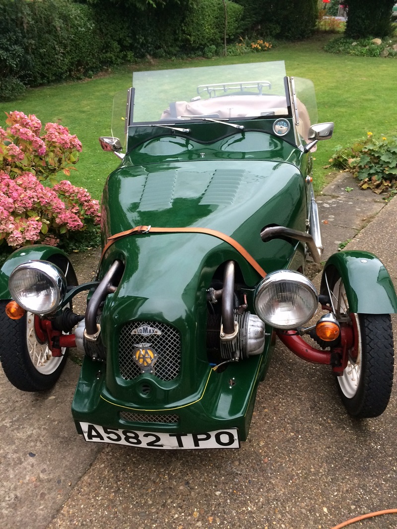

I've also got a pair of small 10" wipers on the windscreen - they are in a chrome mounting, the rubber appears to be integral to the mount. Any ideas what they might be & what I need to try & source as replacements?
I've put a photo below to show what I'm looking for.
Any advice gratefully received.

I've found out the wipers are MG wipers, I found the exact ones on e.bay Austrailia, but no joy elsewhere, so far.

Re Window wiper blades try Car Builder Solutions part number WBR or WBS10 for sprung type

Caterham Seven ones are 10" so might fit OK. I had chrome ones on mine (like your current ones) but they do black too. I have a feeling the chrome ones were fitted to early Landrovers as well!!!

I'd second the suggestion of Landrover wipers. Those I fitted to my Falcon S used the same (rubber pressed between folded metal and a pin through it).. They're designed for use on flat screens only. If I recall I bought them and simply snipped off theeir top end (to required length). They worked well, lasted a long time, much easier to cut size, and very much neater (slimmer) than modern sprung wiper blades..

p.s. pretty car, but I might be inclined to round of those top windscreen corners.. They look potentially painful !
