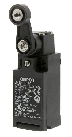

This is how mine works;
As the gear change twists and moves it brings the "roller" on the bracket in line with the arm of the switch and pushes it forward, so turning them on.
Don't know where it came from, but it works even if it looks a "bodge"

The switch in the photo looks similar to RS 621-1515. The roller head and the roller arm can be rotated through 90deg.

Thanks all, for your suggestions. I think I will spec the £18 for the switch and see how I can do it practically on the Burton.
