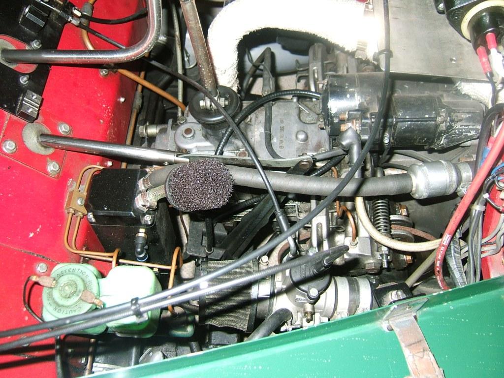

Hi, Had mine going to an additional air filter but decided that this was not very environmentally friendly, so now it goes to a catch tank with small filter on top. No mist around the filter and so far no oil to be seen in the site level tube.
The very nicely machined aluminium catch tank came from Ebay for about £18

What is the aluminium "thing" close to the engine in the inlet pipe supposed to do?
I've got the same thing on mine, but it seems to have nothing inside it; just an open pipe.
