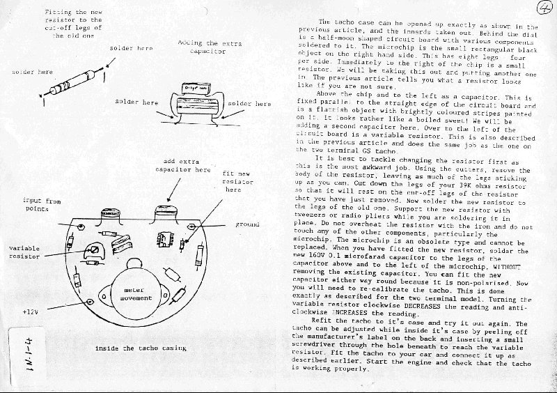

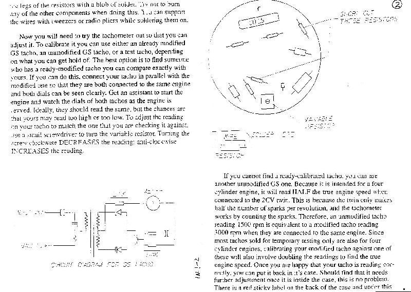

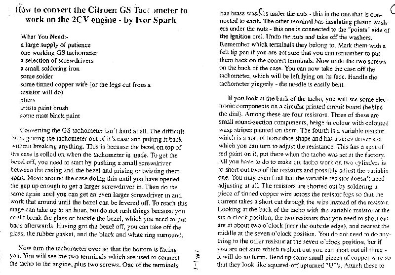

Citroen GS 2 and 3-terminal Tachometer modification instructions (in page order 3,2,1)

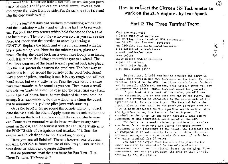

...and the final page
