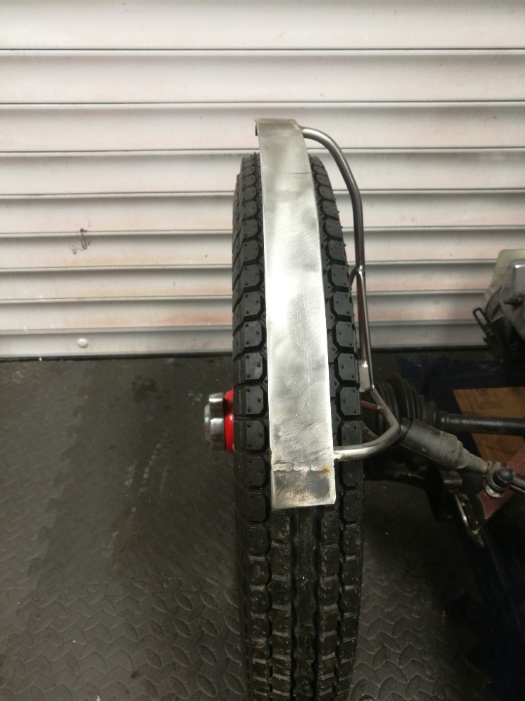

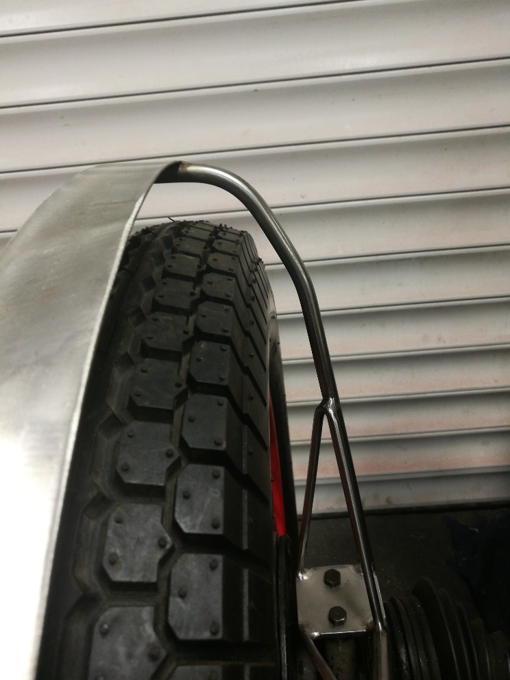

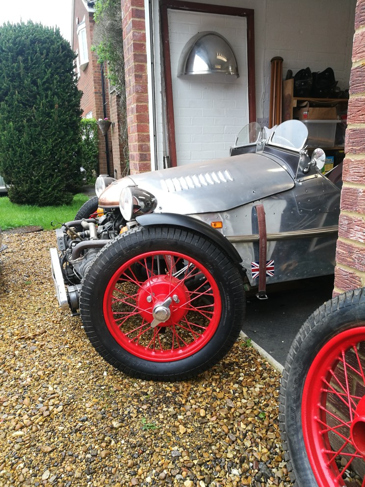

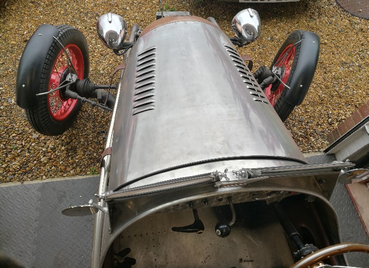

I run these wheels on my Pembleton.
The tyres I have are the Excelsior 400/425 17.
They are big tyres but look the part. They do gear the car up a fair bit too from the standard 2cv wheels, which is only a good thing. Corner holding seems unchanged from the 2cv wheels, apart from the lighter feel due to the increased rolling diameter. I have a speed/rev calculator I've made. What gearbox do you have? What exact brand/size tyres are on currently?
I had some new brackets made up by Tonny Visser and I'm using some alloy mudguards from "feked" that are used on the front of classic bikes like the BSA/Norton's.
I'll upload some images tonight....

Re: 17" tyre suggestions?
Tonny Visser makes and sells stainless mudguard brackets for wings that turn with the wheels. He had them advertised on ebay for a while and they are all made to order depending on your wheels, tyre profile/shape and wing. I can't remember exactly which ones I bought as it was about 9months ago. They're probably a little short for most people as they don't really do much more other than being legal.

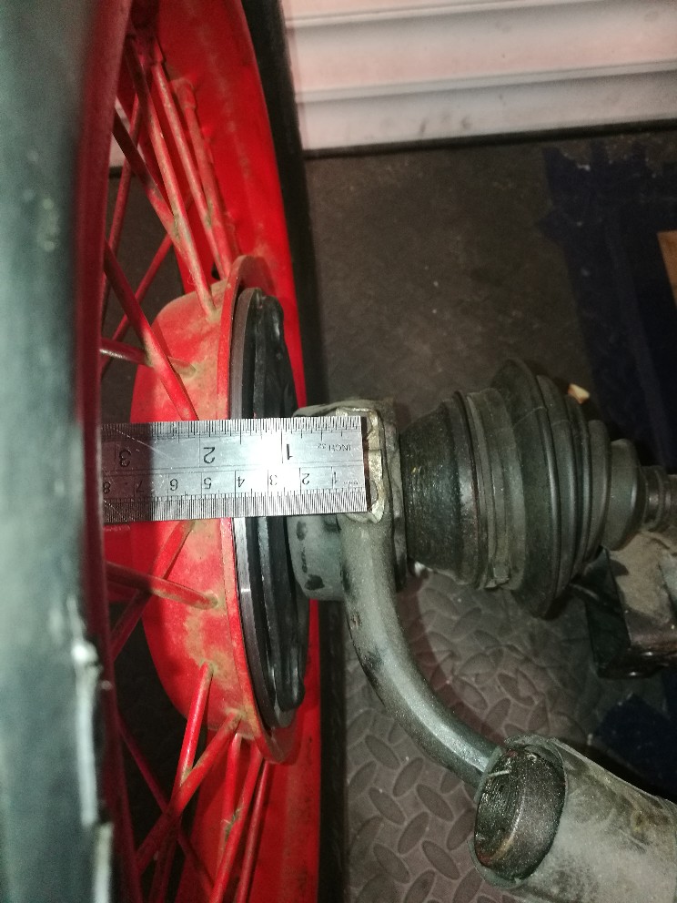

Depending on your adaptor design the measurement below is probably different to mine.
