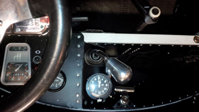

Before going to all the trouble of a gear change conversion, I found gear change was transformed by fitting a different shape gear knob (so you could feel which way the gear lever was pointing).
I turned my new knob from an aluminium off-cut to the shape of one from a D type Jaguar.
Pembleton Super Sport

No wonder you have trouble, your cars upside down
Re: gearchange conversion
Thats what happens when you get told the car has a boat tail

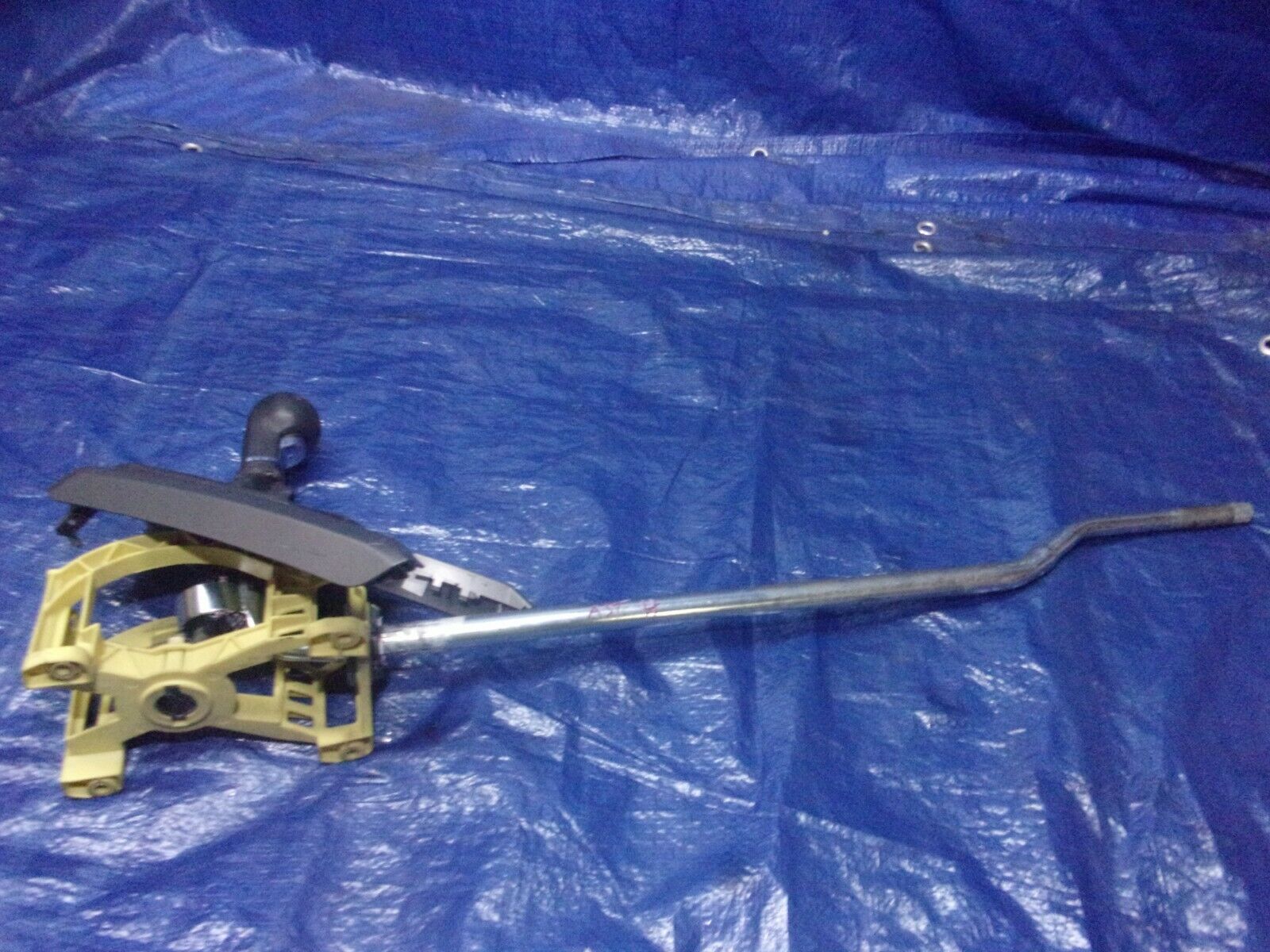

A 2005 Vauxhall Astra gear linkage looks like a good starting point to me...
- 2005 Vauxhaul Astra gearlinkage.jpg (306.95 KiB) Viewed 14606 times
