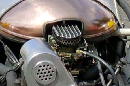

My car too was dying after long periods of tick over/overrun ever since more ethanol has been added to petrol this year.
Cured by installing a larger no 45 idle jet to the late 2cv carb on my Pembleton, this car, fitted with dual megaphone exhausts, performs even better with a 47.5 idle .
A 45 is probably ok on a Lomax with 2 into 1 exhaust.
Hope this helps
Hope this helps
