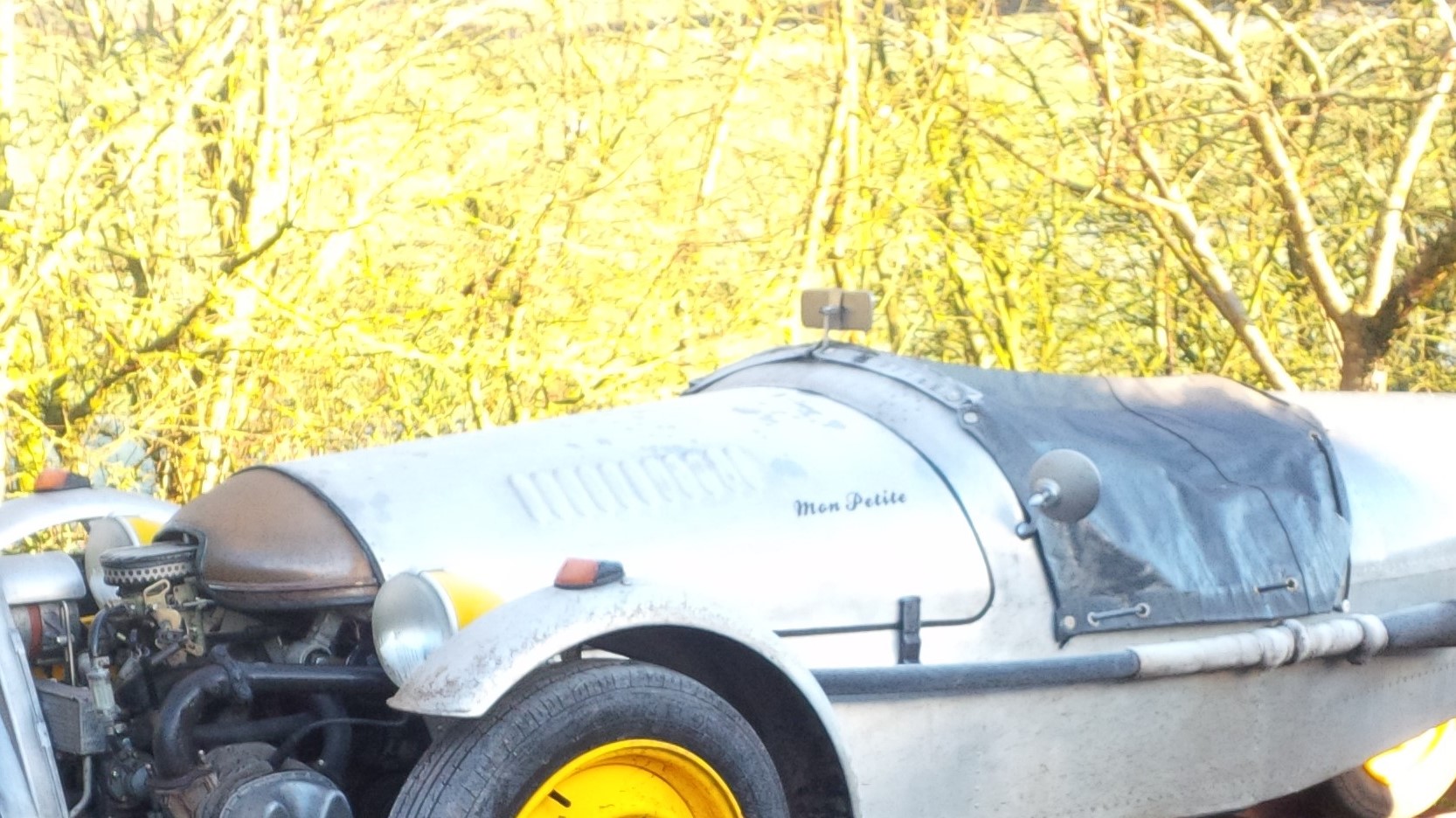

When I bought my Lomax 223 back to 2011, it was fitted with the carburetor heater shopped off from the manifold and the exhaust going across to a silencer on the left side. This exhaust and silencer being rusted and perforated I changed for a 2 in 1. So far sound OK but in chilly days the carburetor is icy.
Then question is what to do?:
1) going back to regular fitting (need to find pipe going through heater box)
2) place an heater on the carburetor:
a) as red here place a cooper wire wrap around exhaust to carburetor
b) as seen on Blackjack Avion circulate oil in the manifold thus heating the carburetor and cooling oil
c) install an heating plug with a switch as in certain petrol car.
Suggestions are welcome
