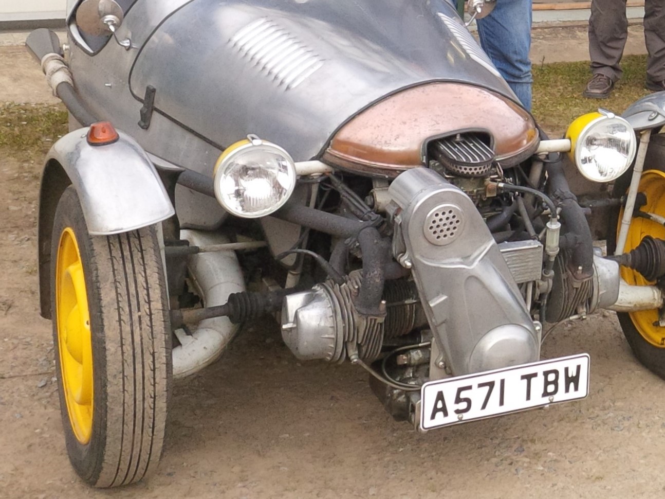

I am running the same carb on my Pembleton, after experimentation I am running the following settings:
Idle 47.5
Primary 115
Secondary 95
Hope this helps
Pembleton SuperSport
Idle 47.5
Primary 115
Secondary 95
Hope this helps
