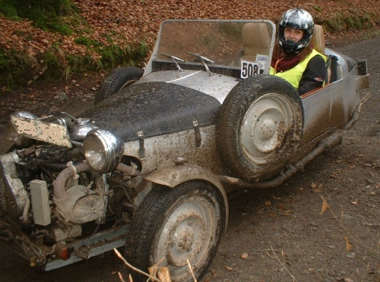

I eventually installed a rear coilover shock from a Rover 200. The bottom of the shock fits into a bracket on the extension of the rear suspension arm as close to the backplate as possible and the top of the shock attaches to a 'saw-horse' type arrangement. This 'saw-horse' type arrangement is bolted to the remains of the rear longtitudinals of the chassis.
The ride height is currently about 300 mm, and can be adjusted by altering the position of the knife edge eye on the standard Citroen suspension.
The arrangement worked well on the trial sections, which had some deep ruts and rocky steps.
- My navigator attempting to stay awake
