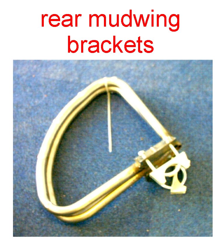

attached is photo of original 224 rear cycle wing brackets.
Not sure when/if Lomaxcars.co.uk propose to restart production of them but believe Graham does have the raw parts.
